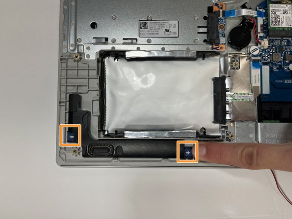

  7. Lenovo IdeaPad 330-15IGM Speaker Units Replacement, Speaker Units: crwdns2935265:07crwdnd2935265:01crwdnd2935265:02crwdne2935265:0 Lenovo IdeaPad 330-15IGM Speaker Units Replacement, Speaker Units: crwdns2935265:07crwdnd2935265:02crwdnd2935265:02crwdne2935265:0
    • Carefully disconnect the speaker from the motherboard.
    • Each speaker unit has blue stoppers that allow it to remain in place. In order to remove the unit, you must nudge the blue stoppers off of the plastic piece it is attached to. Repeat for each speaker.
  8. Lenovo IdeaPad 330-15IGM Speaker Units Replacement: crwdns2935265:08crwdnd2935265:01crwdnd2935265:03crwdne2935265:0 Lenovo IdeaPad 330-15IGM Speaker Units Replacement: crwdns2935265:08crwdnd2935265:02crwdnd2935265:03crwdne2935265:0 Lenovo IdeaPad 330-15IGM Speaker Units Replacement: crwdns2935265:08crwdnd2935265:03crwdnd2935265:03crwdne2935265:0
    • Remove the unit from the chassis and carefully remove the cable that connects the two speaker units together.
    • This cable is vital since it is the only thing that connects the speaker units and allows them to share audio from the motherboard.
