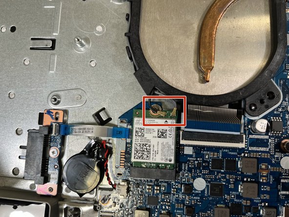

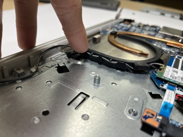

  8. Lenovo IdeaPad 330-15IGM Motherboard Replacement: crwdns2935265:08crwdnd2935265:01crwdnd2935265:03crwdne2935265:0 Lenovo IdeaPad 330-15IGM Motherboard Replacement: crwdns2935265:08crwdnd2935265:02crwdnd2935265:03crwdne2935265:0 Lenovo IdeaPad 330-15IGM Motherboard Replacement: crwdns2935265:08crwdnd2935265:03crwdnd2935265:03crwdne2935265:0
    • The heatsink component has two wires that are tucked into the sides, which are grey and black. It is important to treat these with care as they are connected to the computer's network adapter, which is the green chip below it.

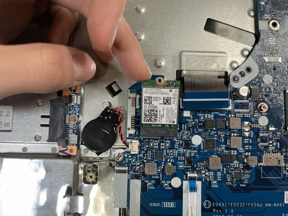

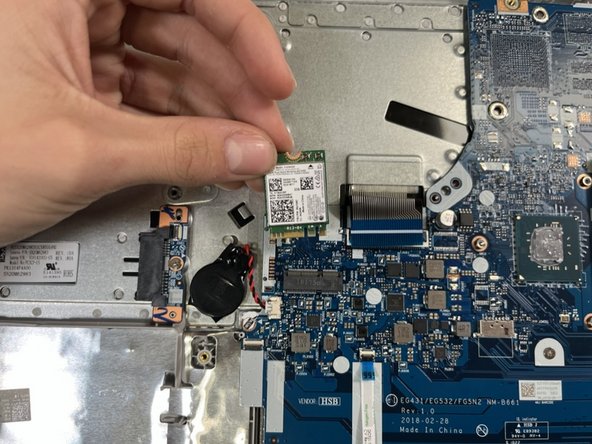

  10. Lenovo IdeaPad 330-15IGM Motherboard Replacement: crwdns2935265:010crwdnd2935265:01crwdnd2935265:03crwdne2935265:0 Lenovo IdeaPad 330-15IGM Motherboard Replacement: crwdns2935265:010crwdnd2935265:02crwdnd2935265:03crwdne2935265:0 Lenovo IdeaPad 330-15IGM Motherboard Replacement: crwdns2935265:010crwdnd2935265:03crwdnd2935265:03crwdne2935265:0
    • Take your Phillips 00 screwdriver and remove the 3mm screw that is holding the network adapter card in place.
    • Removing the screw should cause the card to become propped up at a 45-degree angle. Once it is in this position, simply remove it from its slot.

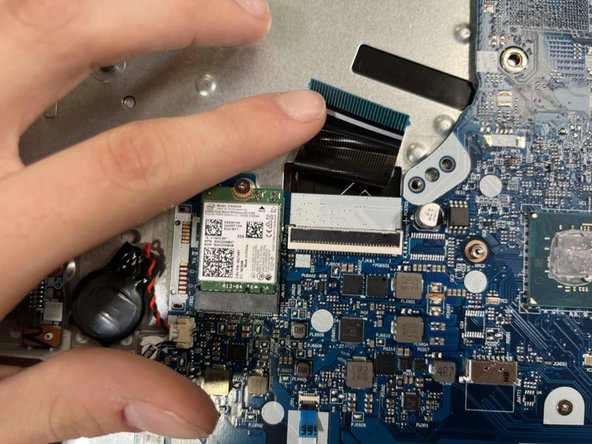

    • Remove the ribbon cable that is now exposed by lifting up the little black tab that holds this down and gently pull back the ribbon.

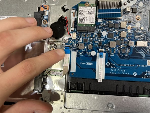

  13. Lenovo IdeaPad 330-15IGM Motherboard Replacement: crwdns2935265:013crwdnd2935265:01crwdnd2935265:01crwdne2935265:0
    • Using the Philips 00 screwdriver, remove the 3mm screw which is located next to the CMOS battery connection. This will allow the motherboard to come loose and be taken out of the chassis.
  14. Lenovo IdeaPad 330-15IGM Motherboard Replacement: crwdns2935265:014crwdnd2935265:01crwdnd2935265:02crwdne2935265:0 Lenovo IdeaPad 330-15IGM Motherboard Replacement: crwdns2935265:014crwdnd2935265:02crwdnd2935265:02crwdne2935265:0

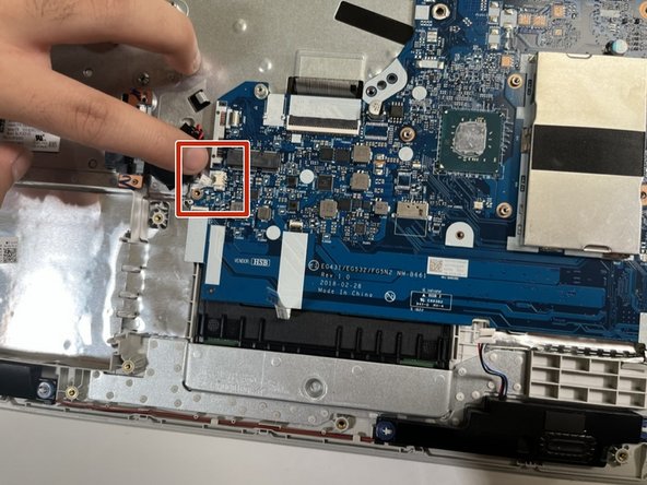

    • Disconnect the CMOS battery connector.

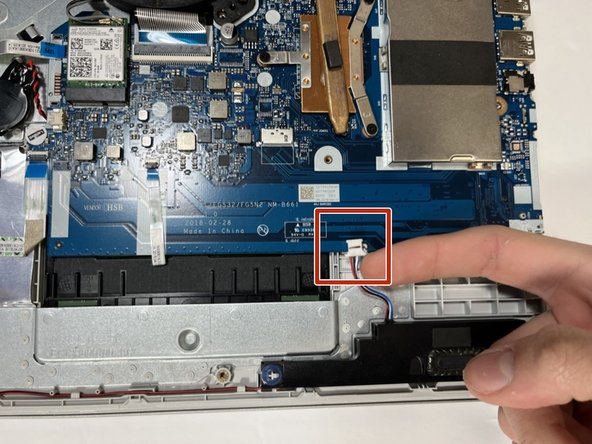

  15. Lenovo IdeaPad 330-15IGM Motherboard Replacement: crwdns2935265:015crwdnd2935265:01crwdnd2935265:02crwdne2935265:0 Lenovo IdeaPad 330-15IGM Motherboard Replacement: crwdns2935265:015crwdnd2935265:02crwdnd2935265:02crwdne2935265:0
    • Remove the speaker connection from the motherboard.

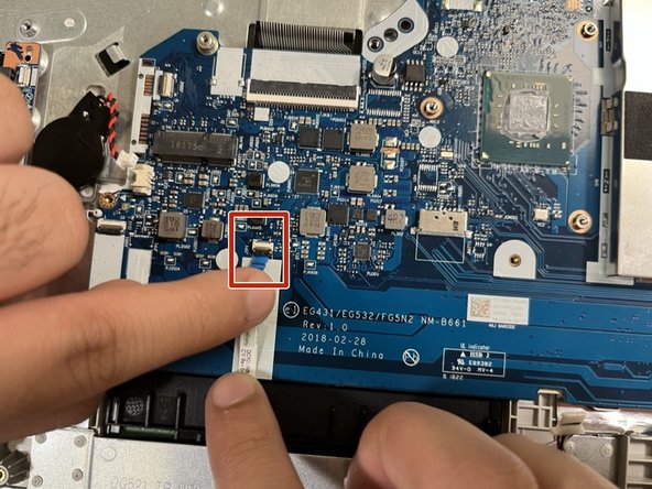

  16. Lenovo IdeaPad 330-15IGM Motherboard Replacement: crwdns2935265:016crwdnd2935265:01crwdnd2935265:02crwdne2935265:0 Lenovo IdeaPad 330-15IGM Motherboard Replacement: crwdns2935265:016crwdnd2935265:02crwdnd2935265:02crwdne2935265:0
    • Remove the touchpad ribbon cable in the same manner as the other ribbon cables. Carefully lift the plastic tab that holds it in place and gently remove the cable until it is free from the slot.

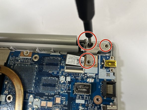

  17. Lenovo IdeaPad 330-15IGM Motherboard Replacement: crwdns2935265:017crwdnd2935265:01crwdnd2935265:02crwdne2935265:0 Lenovo IdeaPad 330-15IGM Motherboard Replacement: crwdns2935265:017crwdnd2935265:02crwdnd2935265:02crwdne2935265:0
    • Remove the two 3mm screws that hold the display onto the motherboard along with the 4.5mm and 6mm screws next to it that hold the top corner of the motherboard to the computer chassis.
    • Once the screws that hold the display onto the motherboard, lift up the metal piece do that the motherboard can be lifted up and out with better ease.

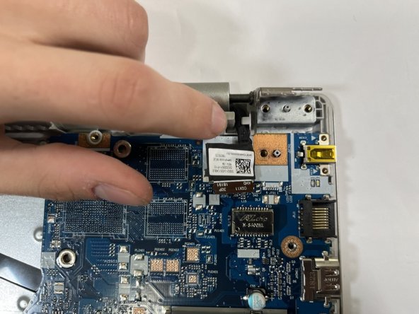

  18. Lenovo IdeaPad 330-15IGM Motherboard Replacement: crwdns2935265:018crwdnd2935265:01crwdnd2935265:02crwdne2935265:0 Lenovo IdeaPad 330-15IGM Motherboard Replacement: crwdns2935265:018crwdnd2935265:02crwdnd2935265:02crwdne2935265:0
    • Carefully lift the plastic that holds the display cable onto the motherboard and gently remove this cable from the slot.
