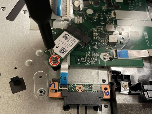

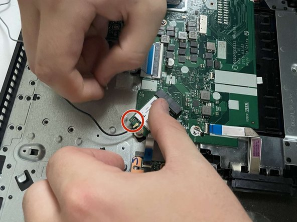

  1. Lenovo IdeaPad 330-15ARR Wi-Fi Card Replacement, Lower Case: crwdns2935265:01crwdnd2935265:01crwdnd2935265:01crwdne2935265:0
    • Remove all Phillips #0 screws securing the case to the laptop.
  2. Lenovo IdeaPad 330-15ARR Wi-Fi Card Replacement: crwdns2935265:02crwdnd2935265:01crwdnd2935265:02crwdne2935265:0 Lenovo IdeaPad 330-15ARR Wi-Fi Card Replacement: crwdns2935265:02crwdnd2935265:02crwdnd2935265:02crwdne2935265:0
    • Pry all edges off of the laptop with the opening tool until the lower case releases.
    • Remove the lower case.

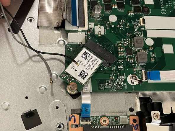

  3. Lenovo IdeaPad 330-15ARR Wi-Fi Card Replacement, Wi-Fi Card: crwdns2935265:03crwdnd2935265:01crwdnd2935265:03crwdne2935265:0 Lenovo IdeaPad 330-15ARR Wi-Fi Card Replacement, Wi-Fi Card: crwdns2935265:03crwdnd2935265:02crwdnd2935265:03crwdne2935265:0 Lenovo IdeaPad 330-15ARR Wi-Fi Card Replacement, Wi-Fi Card: crwdns2935265:03crwdnd2935265:03crwdnd2935265:03crwdne2935265:0
    • Remove the two Wi-Fi card's connections by gently lifting up on the connectors.

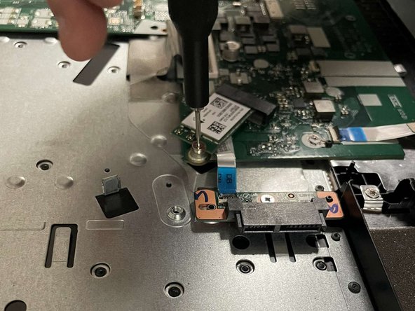

  4. Lenovo IdeaPad 330-15ARR Wi-Fi Card Replacement: crwdns2935265:04crwdnd2935265:01crwdnd2935265:03crwdne2935265:0 Lenovo IdeaPad 330-15ARR Wi-Fi Card Replacement: crwdns2935265:04crwdnd2935265:02crwdnd2935265:03crwdne2935265:0 Lenovo IdeaPad 330-15ARR Wi-Fi Card Replacement: crwdns2935265:04crwdnd2935265:03crwdnd2935265:03crwdne2935265:0
    • Remove the single Phillips #0 screw securing the Wi-Fi card.

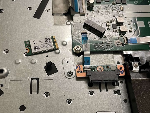

  5. Lenovo IdeaPad 330-15ARR Wi-Fi Card Replacement: crwdns2935265:05crwdnd2935265:01crwdnd2935265:02crwdne2935265:0 Lenovo IdeaPad 330-15ARR Wi-Fi Card Replacement: crwdns2935265:05crwdnd2935265:02crwdnd2935265:02crwdne2935265:0
    • Slide the Wi-Fi card out of its port on the motherboard.
    • Do not worry about the angle the card sits after removing the mounting screw - this is how it's meant to be connected and will have to be connected similarly during reassembly.
