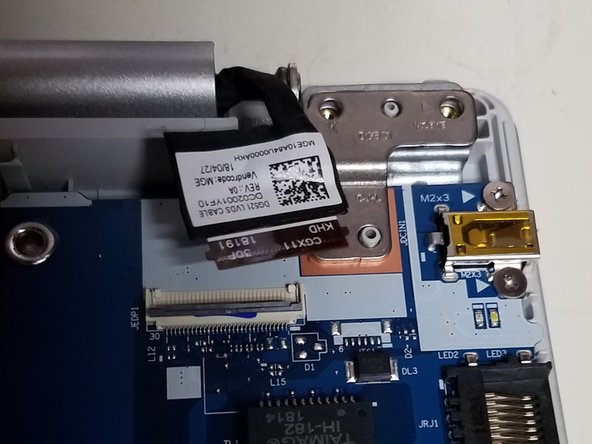

  6. Lenovo IdeaPad 330 Screen Replacement Guide, Disconnect Battery: crwdns2935265:06crwdnd2935265:01crwdnd2935265:03crwdne2935265:0 Lenovo IdeaPad 330 Screen Replacement Guide, Disconnect Battery: crwdns2935265:06crwdnd2935265:02crwdnd2935265:03crwdne2935265:0 Lenovo IdeaPad 330 Screen Replacement Guide, Disconnect Battery: crwdns2935265:06crwdnd2935265:03crwdnd2935265:03crwdne2935265:0
    • 1- Grab a Spudger/Pry Tool
    • 2- Use the tool to carefully push the battery connector out.

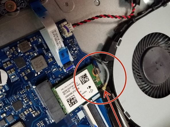

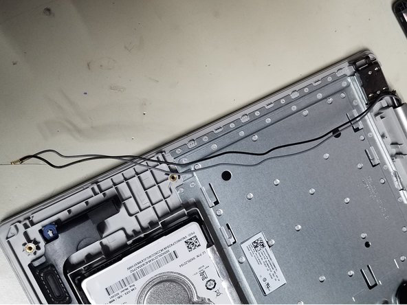

  7. Lenovo IdeaPad 330 Screen Replacement Guide, Remove Antennas from Palm Rest: crwdns2935265:07crwdnd2935265:01crwdnd2935265:03crwdne2935265:0 Lenovo IdeaPad 330 Screen Replacement Guide, Remove Antennas from Palm Rest: crwdns2935265:07crwdnd2935265:02crwdnd2935265:03crwdne2935265:0 Lenovo IdeaPad 330 Screen Replacement Guide, Remove Antennas from Palm Rest: crwdns2935265:07crwdnd2935265:03crwdnd2935265:03crwdne2935265:0
    • 1- Grab a Spudger/ Pry Tool or Two.
    • 2- Gently Remove All Antennas from the Wireless Card.
    • Attention! Make sure to pull the connectors straight up and off. Pulling them off at an angle can damage the connectors.
    • Tip! Use 2 Spudgers or 1 Spudger and a finger nail to grab two sides. Then pull gently wiggle up and off.
    • 3- Gently remove the antenna cables from their groves.
    • Tip! Start at the hinge side to make getting the cables attached to the cpu fan undone easier with the extra slack.

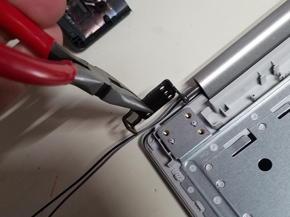

  9. Lenovo IdeaPad 330 Screen Replacement Guide, Remove Screen from Palm Rest: crwdns2935265:09crwdnd2935265:01crwdnd2935265:03crwdne2935265:0 Lenovo IdeaPad 330 Screen Replacement Guide, Remove Screen from Palm Rest: crwdns2935265:09crwdnd2935265:02crwdnd2935265:03crwdne2935265:0 Lenovo IdeaPad 330 Screen Replacement Guide, Remove Screen from Palm Rest: crwdns2935265:09crwdnd2935265:03crwdnd2935265:03crwdne2935265:0

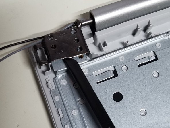

    • 1- Grab your Phillips Head Screwdriver and Remove the 4 hinge screws.
    • 2- Gently use your Spudger/Pry tool to help start separating the hinges from the palm rest, Then Carefully use the Pliers to grab the hinges and open it the rest of the way.
    • 3- Do Step 2 for both hinges.
    • 4- Now the screen should easily pull away from the palm rest.

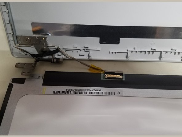

    • 1- Grab your Phillips Head Screwdriver and remove the 4 screws holding in the screen.
    • 2- Carefully release the screen cable shown in the red rectangle from their groves.
    • 3- Carefully lay the screen on its face and lift off the top panel.
    • 4- Next we'll disconnect the video cable from the screen.

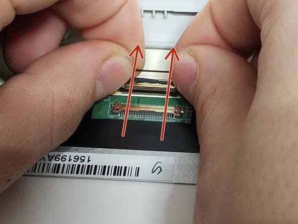

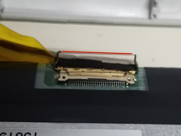

  12. Lenovo IdeaPad 330 Screen Replacement Guide, Removing Screen - Pt2: crwdns2935265:012crwdnd2935265:01crwdnd2935265:03crwdne2935265:0 Lenovo IdeaPad 330 Screen Replacement Guide, Removing Screen - Pt2: crwdns2935265:012crwdnd2935265:02crwdnd2935265:03crwdne2935265:0 Lenovo IdeaPad 330 Screen Replacement Guide, Removing Screen - Pt2: crwdns2935265:012crwdnd2935265:03crwdnd2935265:03crwdne2935265:0
    • 1- Lift up the clip on the video connector on the back of the screen using a Spudger.
    • 2- Grab the clip using both hands and gently and evenly shimy out the video connector.
    • YOUR'E DONE! :) Now time put the new one in by going in reverse.

Simmstudios - crwdns2934203:0crwdne2934203:0
Perfect instructions except for the part about the battery connector. When I went backwards to reconnect the battery I finally figured out that I had removed the holder to the connector (silver) and upon further discovery found I had removed the connectors (wires) from the motherboard. Had to take it to an expert to see if he could solder it back or have the entire motherboard replaced. Need more detailed photos on that section to clearly explain it.
T Stankiewicz - crwdns2934203:0crwdne2934203:0
