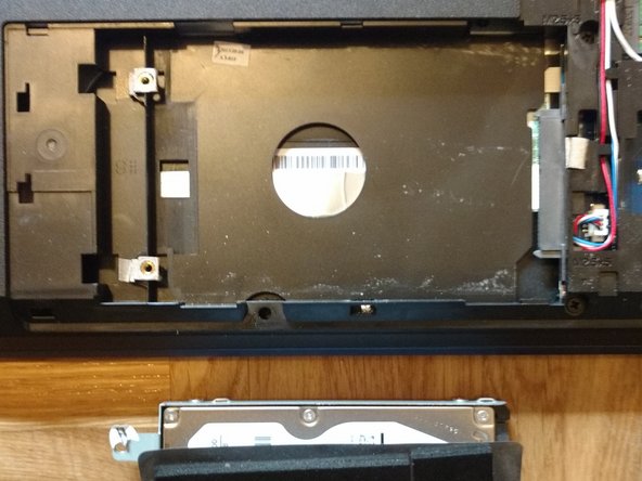

Lenovo IdeaPad 305 Hard Drive Replacement
  1. Lenovo IdeaPad 305 Hard Drive Replacement, Hard Drive: crwdns2935265:01crwdnd2935265:01crwdnd2935265:01crwdne2935265:0
    • Remove the two screws at the back bottom.
  2. Lenovo IdeaPad 305 Hard Drive Replacement: crwdns2935265:02crwdnd2935265:01crwdnd2935265:01crwdne2935265:0
    • Remove the back cover by sliding it out.
  3. Lenovo IdeaPad 305 Hard Drive Replacement: crwdns2935265:03crwdnd2935265:01crwdnd2935265:01crwdne2935265:0
    • Remove the two screws that attach the harddrive to the laptop.
  4. Lenovo IdeaPad 305 Hard Drive Replacement: crwdns2935265:04crwdnd2935265:01crwdnd2935265:02crwdne2935265:0 Lenovo IdeaPad 305 Hard Drive Replacement: crwdns2935265:04crwdnd2935265:02crwdnd2935265:02crwdne2935265:0
    • Disconnect the harddrive connector by sliding it left. Then remove it.
