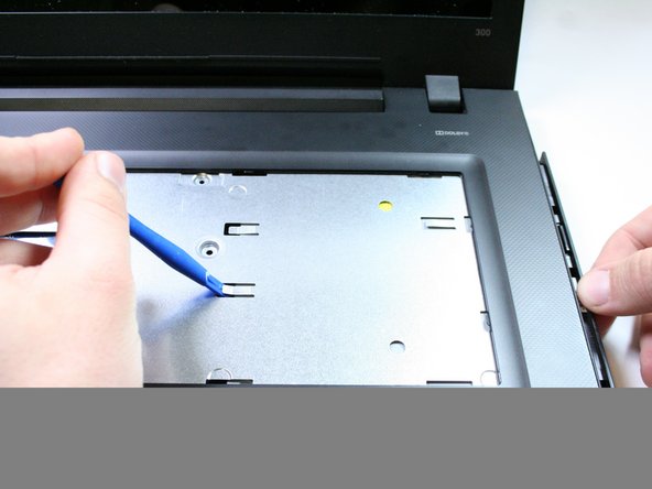

  4. Lenovo IdeaPad 300-17ISK Optical Drive Replacement, Optical Drive: crwdns2935265:04crwdnd2935265:01crwdnd2935265:01crwdne2935265:0
    • Remove the 6mm Phillips #1 screw that sits in the center of the front plate below the keyboard. This screw sits between two adjacent tabbed holes.
  5. Lenovo IdeaPad 300-17ISK Optical Drive Replacement: crwdns2935265:05crwdnd2935265:01crwdnd2935265:03crwdne2935265:0 Lenovo IdeaPad 300-17ISK Optical Drive Replacement: crwdns2935265:05crwdnd2935265:02crwdnd2935265:03crwdne2935265:0 Lenovo IdeaPad 300-17ISK Optical Drive Replacement: crwdns2935265:05crwdnd2935265:03crwdnd2935265:03crwdne2935265:0
    • Insert the opening tool's head into one of the tabbed holes.
    • With the opening tool's head inserted under a tab, push to the right. The optical drive should slide out easily.
