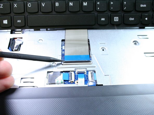

  3. Lenovo IdeaPad 300-17ISK Keyboard Replacement: crwdns2935265:03crwdnd2935265:01crwdnd2935265:02crwdne2935265:0 Lenovo IdeaPad 300-17ISK Keyboard Replacement: crwdns2935265:03crwdnd2935265:02crwdnd2935265:02crwdne2935265:0
    • Push the keyboard connector latch upwards with the spudger.
    • You shouldn't use excessive force. The connector latch is very fragile.
    • The keyboard connector cable should slide right out.
