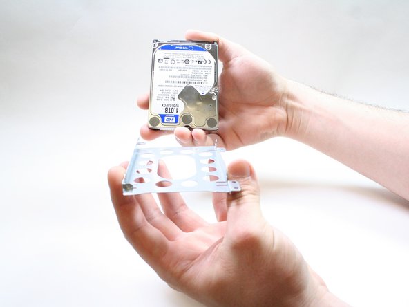

  7. Lenovo IdeaPad 300-17ISK Hard Drive Replacement: crwdns2935265:07crwdnd2935265:01crwdnd2935265:02crwdne2935265:0 Lenovo IdeaPad 300-17ISK Hard Drive Replacement: crwdns2935265:07crwdnd2935265:02crwdnd2935265:02crwdne2935265:0
    • Remove the four 3mm Phillips #1 screws, two on each side, that secure the hard drive in its protective frame.
    • These screws are different from the rest of the laptop screws. You can damage the drive using the wrong screws.
    • Lift the frame to separate it from the hard drive.
