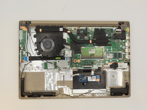

    • Remove the six 5 mm screws located at the top half of the laptop using a Phillips #0 screwdriver.
    • Remove the four 2.5 mm screws located at the bottom of the laptop using a Phillips #0 screwdriver.

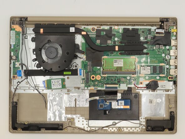

  3. Lenovo IdeaPad 3-15ADA05 Wi-Fi Card Replacement, Battery: crwdns2935265:03crwdnd2935265:01crwdnd2935265:02crwdne2935265:0 Lenovo IdeaPad 3-15ADA05 Wi-Fi Card Replacement, Battery: crwdns2935265:03crwdnd2935265:02crwdnd2935265:02crwdne2935265:0
    • Using a #0 Phillips head, remove the five M2 x 3.5mm screws holding the battery in place.
  4. Lenovo IdeaPad 3-15ADA05 Wi-Fi Card Replacement: crwdns2935265:04crwdnd2935265:01crwdnd2935265:02crwdne2935265:0 Lenovo IdeaPad 3-15ADA05 Wi-Fi Card Replacement: crwdns2935265:04crwdnd2935265:02crwdnd2935265:02crwdne2935265:0
    • Using the opening tool, disconnect the battery connector from the motherboard, and then remove the battery.

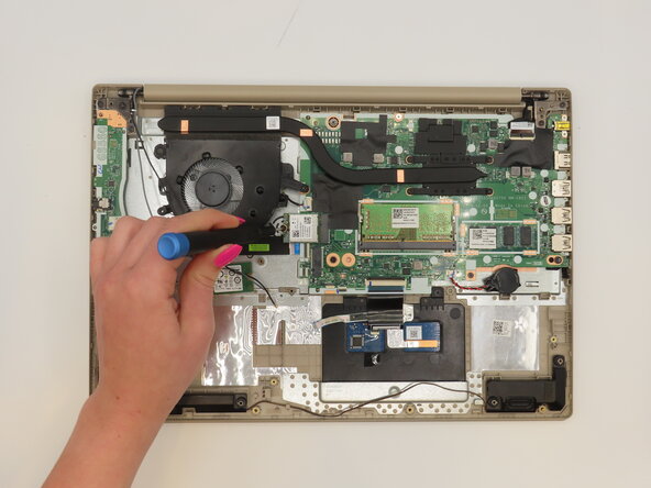

  5. Lenovo IdeaPad 3-15ADA05 Wi-Fi Card Replacement, Wi-Fi Card: crwdns2935265:05crwdnd2935265:01crwdnd2935265:02crwdne2935265:0 Lenovo IdeaPad 3-15ADA05 Wi-Fi Card Replacement, Wi-Fi Card: crwdns2935265:05crwdnd2935265:02crwdnd2935265:02crwdne2935265:0
    • Grip each cable by using the angled tweezers and gently pull it straight out.
    • This will allow you to disconnect the black and white antenna cables from the Wi-Fi card.
  6. Lenovo IdeaPad 3-15ADA05 Wi-Fi Card Replacement: crwdns2935265:06crwdnd2935265:01crwdnd2935265:02crwdne2935265:0 Lenovo IdeaPad 3-15ADA05 Wi-Fi Card Replacement: crwdns2935265:06crwdnd2935265:02crwdnd2935265:02crwdne2935265:0
    • Remove the 3.0 mm screw using a Phillips #00 screwdriver.
  7. Lenovo IdeaPad 3-15ADA05 Wi-Fi Card Replacement: crwdns2935265:07crwdnd2935265:01crwdnd2935265:02crwdne2935265:0 Lenovo IdeaPad 3-15ADA05 Wi-Fi Card Replacement: crwdns2935265:07crwdnd2935265:02crwdnd2935265:02crwdne2935265:0
    • Pull the Wi-Fi card to the left to remove it.
