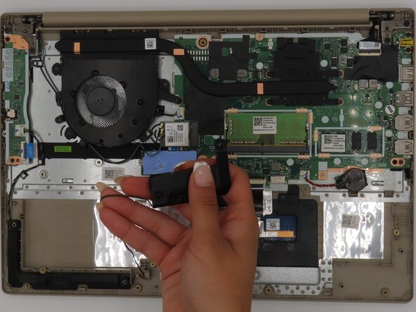

  5. Lenovo IdeaPad 3-15ADA05 Speaker Replacement, Speaker: crwdns2935265:05crwdnd2935265:01crwdnd2935265:02crwdne2935265:0 Lenovo IdeaPad 3-15ADA05 Speaker Replacement, Speaker: crwdns2935265:05crwdnd2935265:02crwdnd2935265:02crwdne2935265:0
    • Remove the small black speaker from the right side using an iFixit opening tool.
    • Gently pull the wire off along the outside.
  6. Lenovo IdeaPad 3-15ADA05 Speaker Replacement: crwdns2935265:06crwdnd2935265:01crwdnd2935265:01crwdne2935265:0
    • Unplug the speaker connector from the circuit board.
  7. Lenovo IdeaPad 3-15ADA05 Speaker Replacement: crwdns2935265:07crwdnd2935265:01crwdnd2935265:01crwdne2935265:0
    • Detach all the wires connected to the small black piece.
