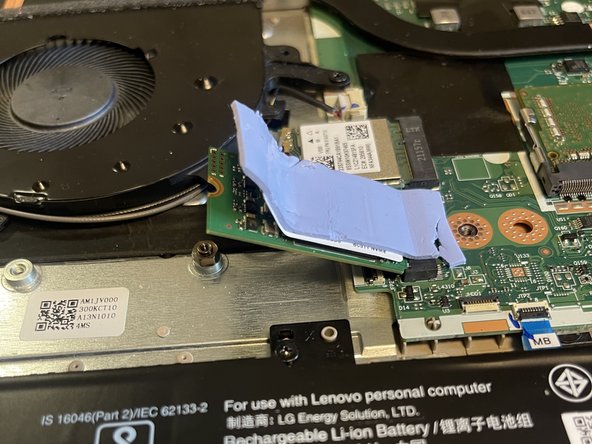

    • Locate the SSD underneath the blue thermal pad on the left side of the motherboard.
    • Peel back the thermal pad to reveal the screw.
  4. Lenovo IdeaPad 3-15ADA05 SSD Replacement: crwdns2935265:04crwdnd2935265:01crwdnd2935265:02crwdne2935265:0 Lenovo IdeaPad 3-15ADA05 SSD Replacement: crwdns2935265:04crwdnd2935265:02crwdnd2935265:02crwdne2935265:0
    • Using a #0 Phillips head, remove the M2 x 3mm screw securing the SSD.
    • The SSD should pop up at a slight angle.
  5. Lenovo IdeaPad 3-15ADA05 SSD Replacement: crwdns2935265:05crwdnd2935265:01crwdnd2935265:02crwdne2935265:0 Lenovo IdeaPad 3-15ADA05 SSD Replacement: crwdns2935265:05crwdnd2935265:02crwdnd2935265:02crwdne2935265:0
    • Slide the SSD out of the slot.
    • Try to keep the thermal pad in one piece to use on the replacement SSD.
