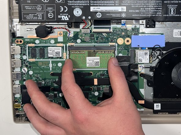

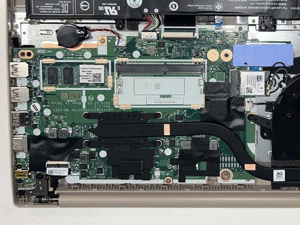

    • Using your fingers, pull the metal arms (located on both sides of the RAM stick) slightly away from it.
    • The RAM will pop up at a slight angle.
  4. Lenovo IdeaPad 3-15ADA05 RAM Replacement: crwdns2935265:04crwdnd2935265:01crwdnd2935265:02crwdne2935265:0 Lenovo IdeaPad 3-15ADA05 RAM Replacement: crwdns2935265:04crwdnd2935265:02crwdnd2935265:02crwdne2935265:0
    • Slide the RAM stick out of the motherboard slot.
