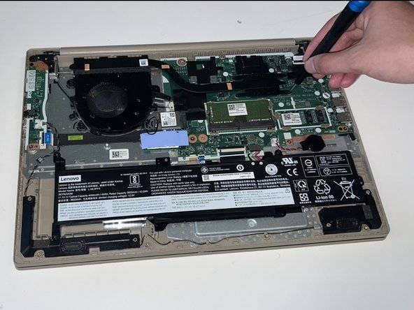

  2. Lenovo IdeaPad 3-15ADA05 Heat Sink Replacement: crwdns2935265:02crwdnd2935265:01crwdnd2935265:02crwdne2935265:0 Lenovo IdeaPad 3-15ADA05 Heat Sink Replacement: crwdns2935265:02crwdnd2935265:02crwdnd2935265:02crwdne2935265:0
    • Insert the blue opening pick between the base plate and the bottom of the laptop.
    • Carefully pry the clips loose around the edges until the base pops off.

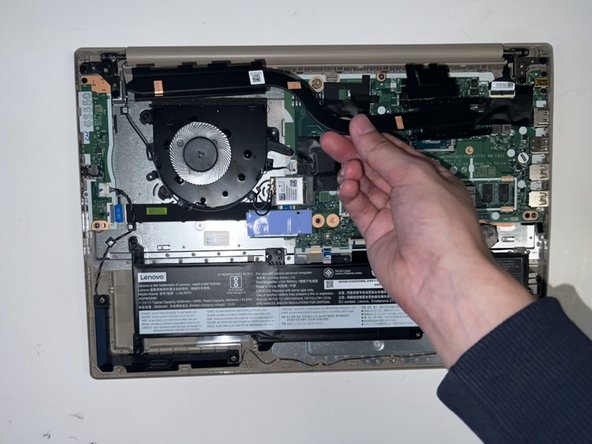

  3. Lenovo IdeaPad 3-15ADA05 Heat Sink Replacement: crwdns2935265:03crwdnd2935265:01crwdnd2935265:03crwdne2935265:0 Lenovo IdeaPad 3-15ADA05 Heat Sink Replacement: crwdns2935265:03crwdnd2935265:02crwdnd2935265:03crwdne2935265:0 Lenovo IdeaPad 3-15ADA05 Heat Sink Replacement: crwdns2935265:03crwdnd2935265:03crwdnd2935265:03crwdne2935265:0
    • Using a Phillips #0 screwdriver, remove the four 3mm screws holding the heat sink in place.

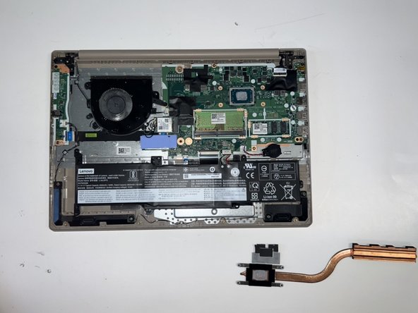

  4. Lenovo IdeaPad 3-15ADA05 Heat Sink Replacement: crwdns2935265:04crwdnd2935265:01crwdnd2935265:02crwdne2935265:0 Lenovo IdeaPad 3-15ADA05 Heat Sink Replacement: crwdns2935265:04crwdnd2935265:02crwdnd2935265:02crwdne2935265:0
    • Remove the heat sink.
    • Be careful not to damage the processor. Remove the heat sink carefully. If it does not remove easily, check for remaining screws or dirt on the heat sink.

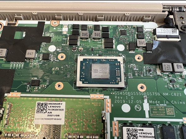

  5. Lenovo IdeaPad 3-15ADA05 Heat Sink Replacement: crwdns2935265:05crwdnd2935265:01crwdnd2935265:02crwdne2935265:0 Lenovo IdeaPad 3-15ADA05 Heat Sink Replacement: crwdns2935265:05crwdnd2935265:02crwdnd2935265:02crwdne2935265:0
    • Using a paper towel, apply a small amount of of rubbing alcohol the paper towel. Then, remove the remaining thermal paste until none is left.

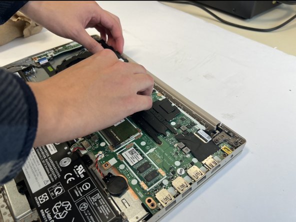

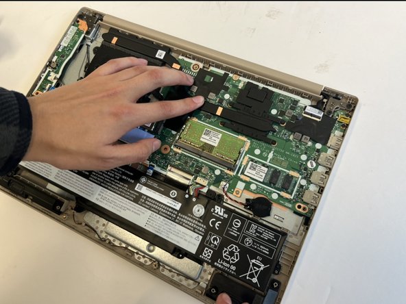

  6. Lenovo IdeaPad 3-15ADA05 Heat Sink Replacement: crwdns2935265:06crwdnd2935265:01crwdnd2935265:03crwdne2935265:0 Lenovo IdeaPad 3-15ADA05 Heat Sink Replacement: crwdns2935265:06crwdnd2935265:02crwdnd2935265:03crwdne2935265:0 Lenovo IdeaPad 3-15ADA05 Heat Sink Replacement: crwdns2935265:06crwdnd2935265:03crwdnd2935265:03crwdne2935265:0
    • Apply a very small amount of thermal paste to the processor (around the size of a grain of rice) evenly. Then, replace the new heat sink and press down gently.
    • Be careful when reattaching the cooler so as not to damage the processor.
    • Tighten the screws in a diagonal pattern to ensure even pressure and spread of the thermal paste.
