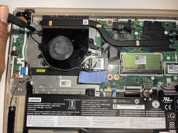

    • Remove the six 5 mm screws located at the top half of the laptop using a Phillips #0 screwdriver.
    • Remove the four 2.5 mm screws located at the bottom of the laptop using a Phillips #0 screwdriver.

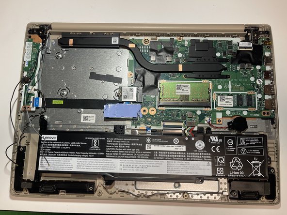

  2. Lenovo IdeaPad 3-15ADA05 Fan Replacement: crwdns2935265:02crwdnd2935265:01crwdnd2935265:02crwdne2935265:0 Lenovo IdeaPad 3-15ADA05 Fan Replacement: crwdns2935265:02crwdnd2935265:02crwdnd2935265:02crwdne2935265:0
    • Insert the opening pick between the base plate and the bottom of the laptop and pry the clips loose around the edge until the base pops off.

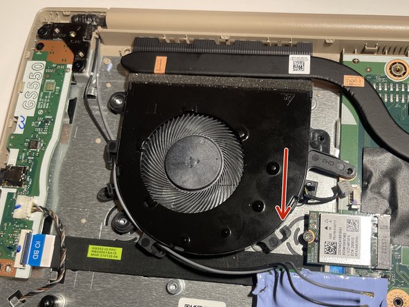

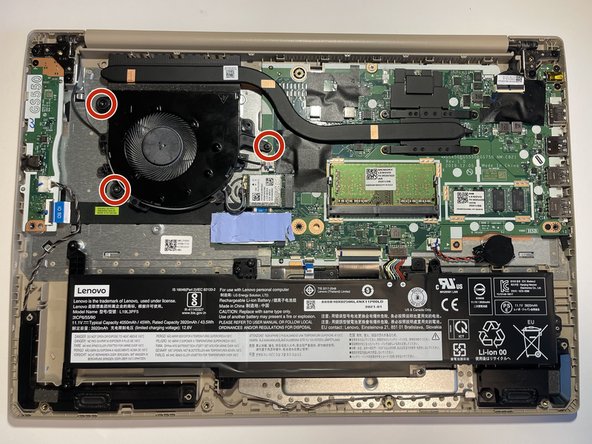

  3. Lenovo IdeaPad 3-15ADA05 Fan Replacement, Fan: crwdns2935265:03crwdnd2935265:01crwdnd2935265:03crwdne2935265:0 Lenovo IdeaPad 3-15ADA05 Fan Replacement, Fan: crwdns2935265:03crwdnd2935265:02crwdnd2935265:03crwdne2935265:0 Lenovo IdeaPad 3-15ADA05 Fan Replacement, Fan: crwdns2935265:03crwdnd2935265:03crwdnd2935265:03crwdne2935265:0
    • Remove the two M2 x 3.30mm screws using the #0 screw head, then remove the one M2 x 5mm screw using the #0 screw head.

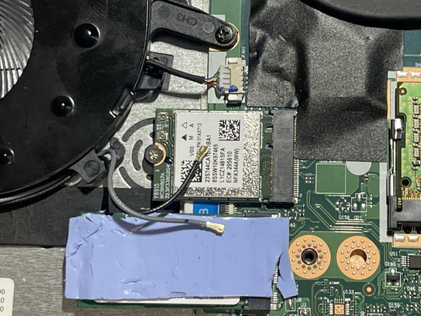

  4. Lenovo IdeaPad 3-15ADA05 Fan Replacement: crwdns2935265:04crwdnd2935265:01crwdnd2935265:03crwdne2935265:0 Lenovo IdeaPad 3-15ADA05 Fan Replacement: crwdns2935265:04crwdnd2935265:02crwdnd2935265:03crwdne2935265:0 Lenovo IdeaPad 3-15ADA05 Fan Replacement: crwdns2935265:04crwdnd2935265:03crwdnd2935265:03crwdne2935265:0
    • Disconnect the black and white antenna cables from the wireless card using the opening tool.

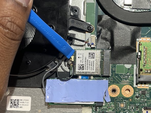

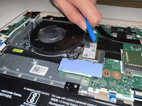

  5. Lenovo IdeaPad 3-15ADA05 Fan Replacement: crwdns2935265:05crwdnd2935265:01crwdnd2935265:03crwdne2935265:0 Lenovo IdeaPad 3-15ADA05 Fan Replacement: crwdns2935265:05crwdnd2935265:02crwdnd2935265:03crwdne2935265:0 Lenovo IdeaPad 3-15ADA05 Fan Replacement: crwdns2935265:05crwdnd2935265:03crwdnd2935265:03crwdne2935265:0
    • Disconnect the fan cable from the motherboard using the opening tool.

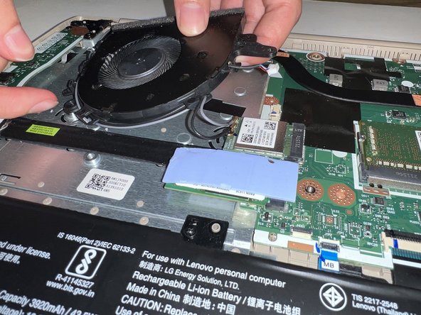

  6. Lenovo IdeaPad 3-15ADA05 Fan Replacement: crwdns2935265:06crwdnd2935265:01crwdnd2935265:03crwdne2935265:0 Lenovo IdeaPad 3-15ADA05 Fan Replacement: crwdns2935265:06crwdnd2935265:02crwdnd2935265:03crwdne2935265:0 Lenovo IdeaPad 3-15ADA05 Fan Replacement: crwdns2935265:06crwdnd2935265:03crwdnd2935265:03crwdne2935265:0
    • Unwrap the cord from the three clips, then remove the fan.
    • To remove the cords, push them through the small gap shown by the arrow.
