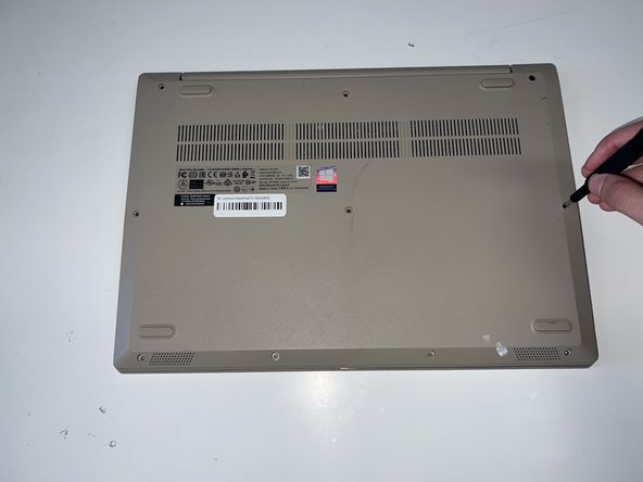

  1. Lenovo IdeaPad 3-15ADA05 Display Replacement, Back Panel: crwdns2935265:01crwdnd2935265:01crwdnd2935265:02crwdne2935265:0 Lenovo IdeaPad 3-15ADA05 Display Replacement, Back Panel: crwdns2935265:01crwdnd2935265:02crwdnd2935265:02crwdne2935265:0
    • Remove the six 5 mm screws located at the top half of the laptop using a Phillips #0 screwdriver.
    • Remove the four 2.5 mm screws located at the bottom of the laptop using a Phillips #0 screwdriver.
  2. Lenovo IdeaPad 3-15ADA05 Display Replacement: crwdns2935265:02crwdnd2935265:01crwdnd2935265:02crwdne2935265:0 Lenovo IdeaPad 3-15ADA05 Display Replacement: crwdns2935265:02crwdnd2935265:02crwdnd2935265:02crwdne2935265:0
    • Insert the opening pick between the base plate and the bottom of the laptop and pry the clips loose around the edge until the base pops off.

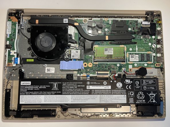

  3. Lenovo IdeaPad 3-15ADA05 Display Replacement, Battery: crwdns2935265:03crwdnd2935265:01crwdnd2935265:02crwdne2935265:0 Lenovo IdeaPad 3-15ADA05 Display Replacement, Battery: crwdns2935265:03crwdnd2935265:02crwdnd2935265:02crwdne2935265:0
    • Using a #0 Phillips head, remove the five M2 x 3.5mm screws holding the battery in place.
  4. Lenovo IdeaPad 3-15ADA05 Display Replacement: crwdns2935265:04crwdnd2935265:01crwdnd2935265:02crwdne2935265:0 Lenovo IdeaPad 3-15ADA05 Display Replacement: crwdns2935265:04crwdnd2935265:02crwdnd2935265:02crwdne2935265:0
    • Using the opening tool, disconnect the battery connector from the motherboard, and then remove the battery.

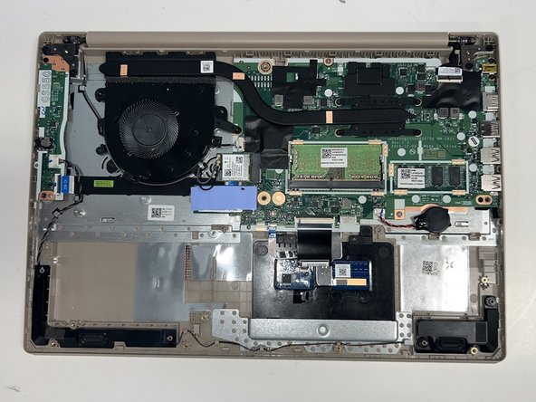

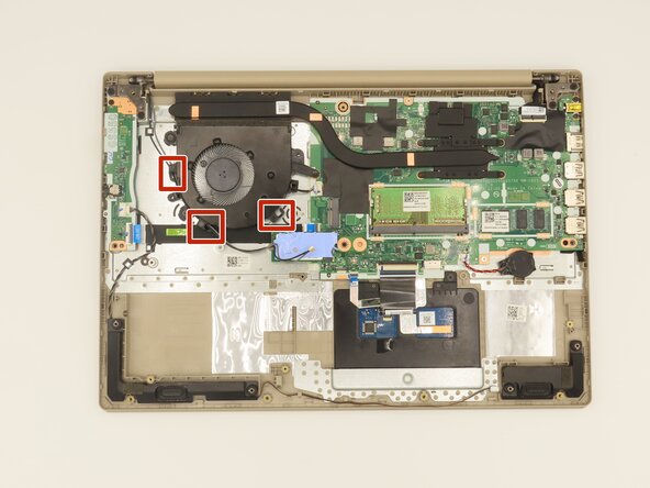

  5. Lenovo IdeaPad 3-15ADA05 Display Replacement, Display: crwdns2935265:05crwdnd2935265:01crwdnd2935265:02crwdne2935265:0 Lenovo IdeaPad 3-15ADA05 Display Replacement, Display: crwdns2935265:05crwdnd2935265:02crwdnd2935265:02crwdne2935265:0
    • Disconnect the black and white antenna cables from the wireless card using the opening tool.
    • Unwrap the cord from the three clips.
    • To remove the cords, push them through the small gaps.

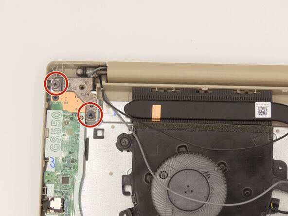

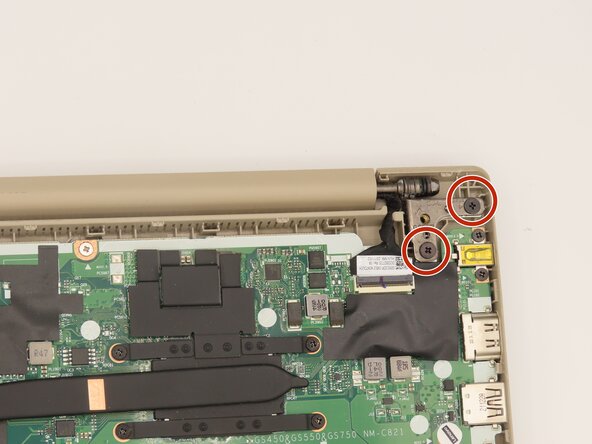

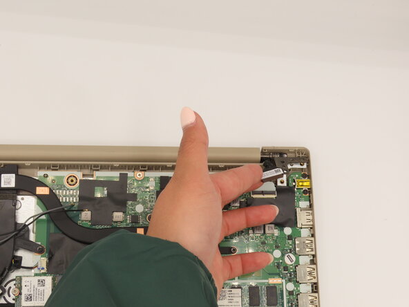

  6. Lenovo IdeaPad 3-15ADA05 Display Replacement: crwdns2935265:06crwdnd2935265:01crwdnd2935265:03crwdne2935265:0 Lenovo IdeaPad 3-15ADA05 Display Replacement: crwdns2935265:06crwdnd2935265:02crwdnd2935265:03crwdne2935265:0 Lenovo IdeaPad 3-15ADA05 Display Replacement: crwdns2935265:06crwdnd2935265:03crwdnd2935265:03crwdne2935265:0
    • Remove the four 7 mm screws from both hinges using a Phillips #0 screwdriver.
  7. Lenovo IdeaPad 3-15ADA05 Display Replacement: crwdns2935265:07crwdnd2935265:01crwdnd2935265:02crwdne2935265:0 Lenovo IdeaPad 3-15ADA05 Display Replacement: crwdns2935265:07crwdnd2935265:02crwdnd2935265:02crwdne2935265:0
    • Using iFixit precision tweezers, remove the LCD cable from its slot.
