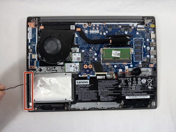

  2. Lenovo IdeaPad 3-14IIL05 Speaker Replacement, Speaker: crwdns2935265:02crwdnd2935265:01crwdnd2935265:01crwdne2935265:0
    • Disconnect the speakers by removing the cord from the sound chip.
  3. Lenovo IdeaPad 3-14IIL05 Speaker Replacement: crwdns2935265:03crwdnd2935265:01crwdnd2935265:01crwdne2935265:0
    • Remove the screw from the bottom left corner.
  4. Lenovo IdeaPad 3-14IIL05 Speaker Replacement: crwdns2935265:04crwdnd2935265:01crwdnd2935265:01crwdne2935265:0
    • Remove the speakers along the channel located at the bottom of the laptop.
