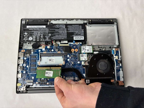

    • Flip the laptop with the screen side facing down and the back panel facing you.
    • Remove the six 1.2 mm screws and the four 0.6 mm screws using a Phillips #1 screwdriver.
    • Make sure to separate the different sizes from each other.

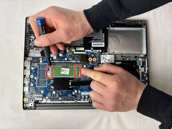

    • Hold the two clips on either end of the short side of the RAM and push them apart.
    • The RAM will pop up.
    • Remove the RAM.
