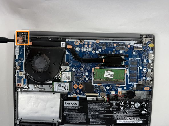

    • Flip the laptop with the screen side facing down and the back panel facing you.
    • Remove the six 1.2 mm screws and the four 0.6 mm screws using a Phillips #1 screwdriver.
    • Make sure to separate the different sizes from each other.

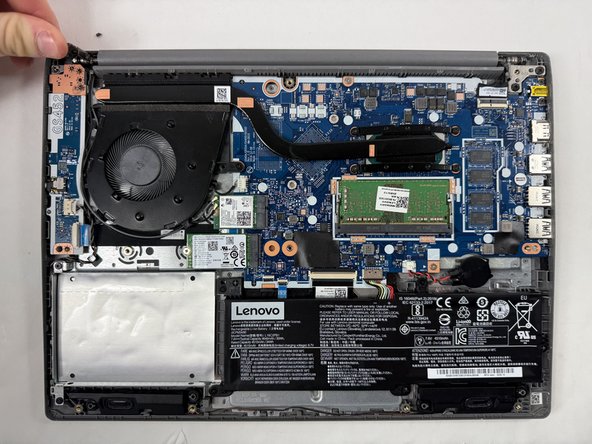

  2. Lenovo IdeaPad 3-14IIL05 Daughterboard Replacement, Daughterboard: crwdns2935265:02crwdnd2935265:01crwdnd2935265:03crwdne2935265:0 Lenovo IdeaPad 3-14IIL05 Daughterboard Replacement, Daughterboard: crwdns2935265:02crwdnd2935265:02crwdnd2935265:03crwdne2935265:0 Lenovo IdeaPad 3-14IIL05 Daughterboard Replacement, Daughterboard: crwdns2935265:02crwdnd2935265:03crwdnd2935265:03crwdne2935265:0
    • Remove the four screws from the daughterboard.
    • Lift up the L-shaped bracket.

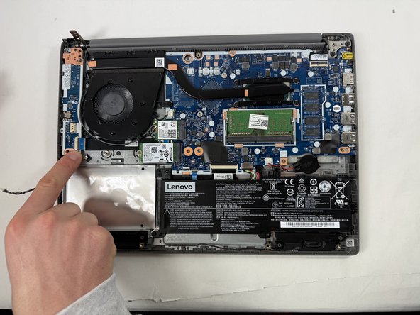

  3. Lenovo IdeaPad 3-14IIL05 Daughterboard Replacement: crwdns2935265:03crwdnd2935265:01crwdnd2935265:03crwdne2935265:0 Lenovo IdeaPad 3-14IIL05 Daughterboard Replacement: crwdns2935265:03crwdnd2935265:02crwdnd2935265:03crwdne2935265:0 Lenovo IdeaPad 3-14IIL05 Daughterboard Replacement: crwdns2935265:03crwdnd2935265:03crwdnd2935265:03crwdne2935265:0
    • Unplug the ribbon cable from the daughterboard by flipping the clamp up.

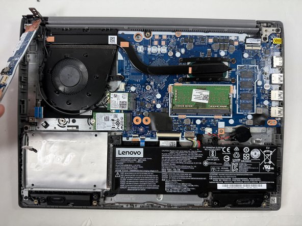

    • Remove the daughterboard.
