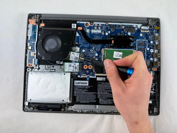

    • Flip the laptop with the screen side facing down and the back panel facing you.
    • Remove the six 1.2 mm screws and the four 0.6 mm screws using a Phillips #1 screwdriver.
    • Make sure to separate the different sizes from each other.
  2. Lenovo IdeaPad 3-14IIL05 Cooling Fan Replacement, Cooling Fan: crwdns2935265:02crwdnd2935265:01crwdnd2935265:02crwdne2935265:0 Lenovo IdeaPad 3-14IIL05 Cooling Fan Replacement, Cooling Fan: crwdns2935265:02crwdnd2935265:02crwdnd2935265:02crwdne2935265:0
    • Remove the single screw from the Wi-Fi card.
    • Detach the wires from the Wi-Fi card.
  3. Lenovo IdeaPad 3-14IIL05 Cooling Fan Replacement: crwdns2935265:03crwdnd2935265:01crwdnd2935265:01crwdne2935265:0
    • Remove the two screws from the fan.
    • The screw closest to the wire clip connection to the motherboard is longer than the other screws.
