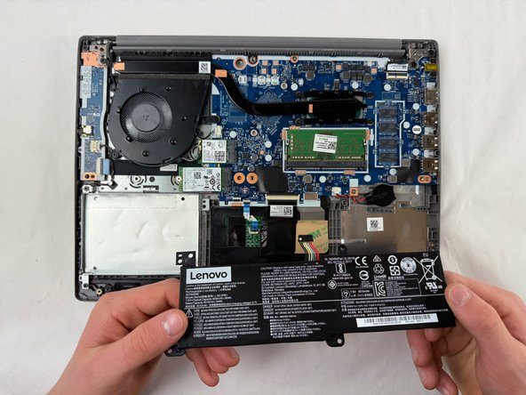

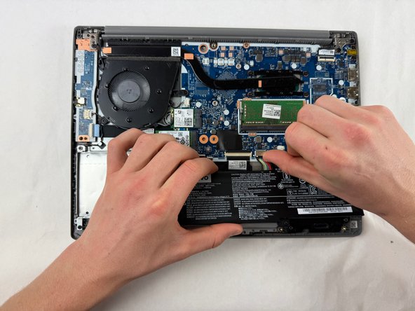

  2. Lenovo IdeaPad 3-14IIL05 Battery Replacement, Battery: crwdns2935265:02crwdnd2935265:01crwdnd2935265:03crwdne2935265:0 Lenovo IdeaPad 3-14IIL05 Battery Replacement, Battery: crwdns2935265:02crwdnd2935265:02crwdnd2935265:03crwdne2935265:0 Lenovo IdeaPad 3-14IIL05 Battery Replacement, Battery: crwdns2935265:02crwdnd2935265:03crwdnd2935265:03crwdne2935265:0
    • Remove the screws holding down the battery.
    • Unplug the battery from the motherboard.
    • Remove the battery from the laptop.
