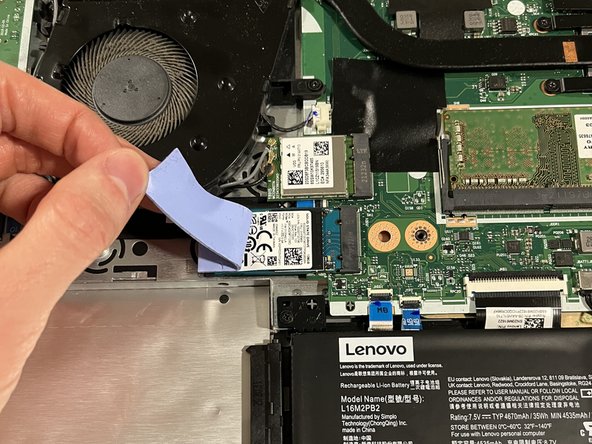

  3. Lenovo IdeaPad 3-1481W000NGUS SSD Replacement, SSD: crwdns2935265:03crwdnd2935265:01crwdnd2935265:03crwdne2935265:0 Lenovo IdeaPad 3-1481W000NGUS SSD Replacement, SSD: crwdns2935265:03crwdnd2935265:02crwdnd2935265:03crwdne2935265:0 Lenovo IdeaPad 3-1481W000NGUS SSD Replacement, SSD: crwdns2935265:03crwdnd2935265:03crwdnd2935265:03crwdne2935265:0
    • Gently peel away the blue thermal pad, revealing the SSD underneath.
    • Do not set the sticky bottom side of the thermal pad on any surface.

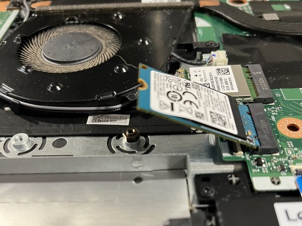

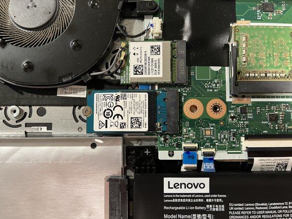

    • Remove the 4 mm screw keeping the SSD in place using a Phillips #00 screwdriver.
  5. Lenovo IdeaPad 3-1481W000NGUS SSD Replacement: crwdns2935265:05crwdnd2935265:01crwdnd2935265:01crwdne2935265:0
    • Pull the SSD out straight, without applying any vertical pressure.
    • When removing, do not pull the SSD upwards. This may damage the motherboard slot and hard drive.
