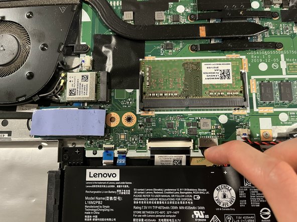

  3. Lenovo IdeaPad 3-1481W000NGUS RAM Replacement, RAM: crwdns2935265:03crwdnd2935265:01crwdnd2935265:02crwdne2935265:0 Lenovo IdeaPad 3-1481W000NGUS RAM Replacement, RAM: crwdns2935265:03crwdnd2935265:02crwdnd2935265:02crwdne2935265:0
    • Use your fingernail or an opening tool to gently pull out and disconnect the battery pack cable.
    • Do not pull on the cables.

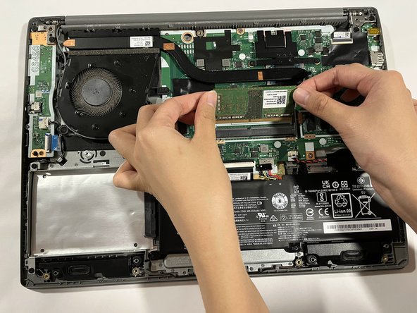

  4. Lenovo IdeaPad 3-1481W000NGUS RAM Replacement: crwdns2935265:04crwdnd2935265:01crwdnd2935265:02crwdne2935265:0 Lenovo IdeaPad 3-1481W000NGUS RAM Replacement: crwdns2935265:04crwdnd2935265:02crwdnd2935265:02crwdne2935265:0
    • Disengage the latch of the RAM by pushing outwards on the left and right side of the memory module slot.
  5. Lenovo IdeaPad 3-1481W000NGUS RAM Replacement: crwdns2935265:05crwdnd2935265:01crwdnd2935265:02crwdne2935265:0 Lenovo IdeaPad 3-1481W000NGUS RAM Replacement: crwdns2935265:05crwdnd2935265:02crwdnd2935265:02crwdne2935265:0
    • Remove the RAM by sliding it out of its slot.
