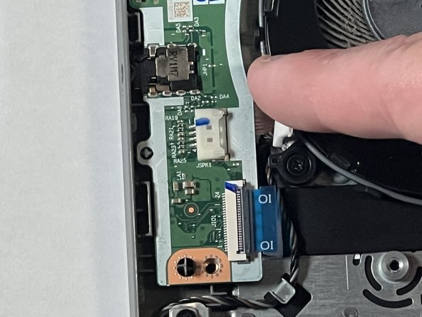

  3. Lenovo IdeaPad 3-1481W000NGUS I/O Board Replacement, I/O Board: crwdns2935265:03crwdnd2935265:01crwdnd2935265:02crwdne2935265:0 Lenovo IdeaPad 3-1481W000NGUS I/O Board Replacement, I/O Board: crwdns2935265:03crwdnd2935265:02crwdnd2935265:02crwdne2935265:0
    • Use your fingernail or an opening tool to gently pull out and disconnect the battery pack cable.
    • Do not pull on the cables.

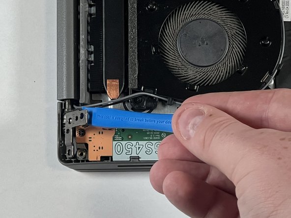

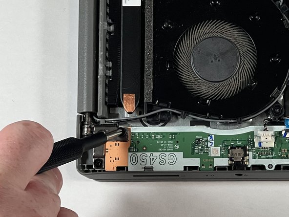

    • Remove the two 4 mm screws from the screen assembly hinge using a Phillips #00 screwdriver.
    • Using the opening tool, open the hinge away from the I/O board.

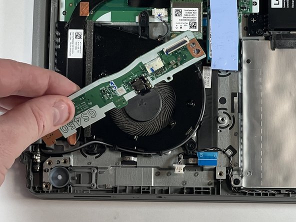

  6. Lenovo IdeaPad 3-1481W000NGUS I/O Board Replacement: crwdns2935265:06crwdnd2935265:01crwdnd2935265:02crwdne2935265:0 Lenovo IdeaPad 3-1481W000NGUS I/O Board Replacement: crwdns2935265:06crwdnd2935265:02crwdnd2935265:02crwdne2935265:0
    • Rotate the I/O board to pull out.
