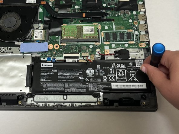

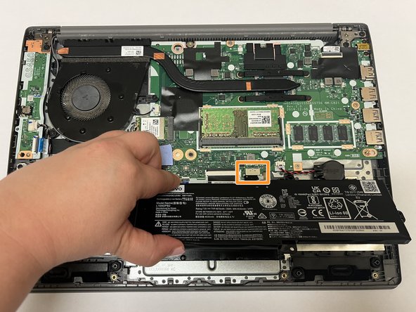

  3. Lenovo IdeaPad 3-1481W000NGUS Battery Replacement, Battery: crwdns2935265:03crwdnd2935265:01crwdnd2935265:03crwdne2935265:0 Lenovo IdeaPad 3-1481W000NGUS Battery Replacement, Battery: crwdns2935265:03crwdnd2935265:02crwdnd2935265:03crwdne2935265:0 Lenovo IdeaPad 3-1481W000NGUS Battery Replacement, Battery: crwdns2935265:03crwdnd2935265:03crwdnd2935265:03crwdne2935265:0
    • Remove the three 4 mm screws connected to the battery pack using a Phillips #000 screwdriver.
    • Disconnect the battery cable from the motherboard.
    • Gently lift up the battery pack by hand to remove it.
    • Be sure to avoid pulling the plug cable.
