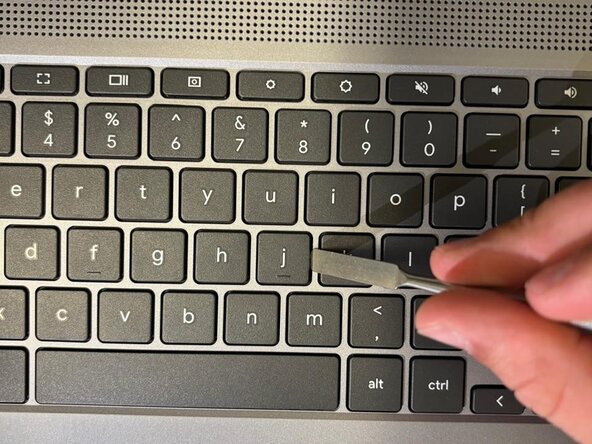

    • Use a spudger to slide it underneath one side of the key and gently tilt it to pop open the key.

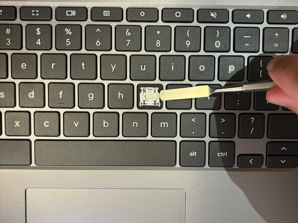

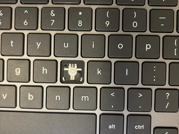

    • Insert a spudger underneath the scissor switch and pry it up.
