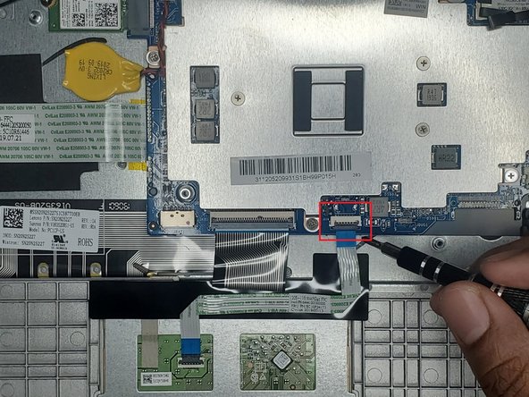

    • Use a pair of tweezers to lift the clip securing the touchpad cable.
    • Disconnect the touchpad cable from the motherboard.
