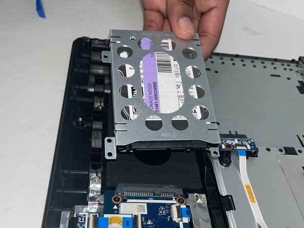

  5. Lenovo IdeaPad 110-17IKB Hard Disk Drive Replacement, Hard Disk Drive (HDD): crwdns2935265:05crwdnd2935265:01crwdnd2935265:01crwdne2935265:0
    • Use a Phillips #1 screwdriver to unscrew the four 5 mm screws that are holding the hard drive in place.
  6. Lenovo IdeaPad 110-17IKB Hard Disk Drive Replacement: crwdns2935265:06crwdnd2935265:01crwdnd2935265:02crwdne2935265:0 Lenovo IdeaPad 110-17IKB Hard Disk Drive Replacement: crwdns2935265:06crwdnd2935265:02crwdnd2935265:02crwdne2935265:0
    • Do not lift the hard drive straight up; this might break the connection port.
    • Softly slide the hard drive away from the port.

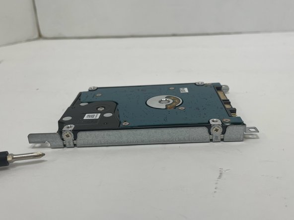

  7. Lenovo IdeaPad 110-17IKB Hard Disk Drive Replacement: crwdns2935265:07crwdnd2935265:01crwdnd2935265:02crwdne2935265:0 Lenovo IdeaPad 110-17IKB Hard Disk Drive Replacement: crwdns2935265:07crwdnd2935265:02crwdnd2935265:02crwdne2935265:0
    • Use a Phillips #1 screwdriver remove the 2 screws from both sides of the hard drive (total of 4 screws).
  8. Lenovo IdeaPad 110-17IKB Hard Disk Drive Replacement: crwdns2935265:08crwdnd2935265:01crwdnd2935265:01crwdne2935265:0
    • Remove the hard drive from the housing mount.
