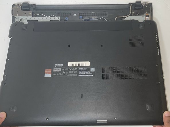

    • First, before you do anything, make sure the computer has been turned off and unplugged.
    • Place the the computer bottom facing up. Unscrew the eleven 6 mm screws using a Phillips #0 screwdriver.
  2. Lenovo IdeaPad 110-17IKB Fan Replacement: crwdns2935265:02crwdnd2935265:01crwdnd2935265:02crwdne2935265:0 Lenovo IdeaPad 110-17IKB Fan Replacement: crwdns2935265:02crwdnd2935265:02crwdnd2935265:02crwdne2935265:0
    • Use an opening tool to gently disconnect the clips on the side of the back panel.
    • DO NOT try to force open the panel, as this may cause damage to it.
  3. Lenovo IdeaPad 110-17IKB Fan Replacement: crwdns2935265:03crwdnd2935265:01crwdnd2935265:02crwdne2935265:0 Lenovo IdeaPad 110-17IKB Fan Replacement: crwdns2935265:03crwdnd2935265:02crwdnd2935265:02crwdne2935265:0

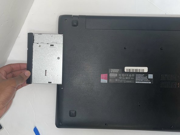

    • Pry out the optical drive opposite of the laptop.
    • Since the screws have already been removed, you will not need to worry about any more screws on the optical drive.

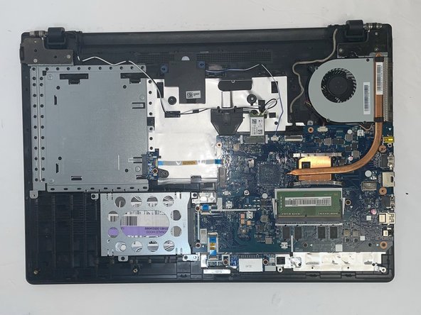

    • Release the remaining clasp and remove the lower case.
  5. Lenovo IdeaPad 110-17IKB Fan Replacement, Fan: crwdns2935265:05crwdnd2935265:01crwdnd2935265:02crwdne2935265:0 Lenovo IdeaPad 110-17IKB Fan Replacement, Fan: crwdns2935265:05crwdnd2935265:02crwdnd2935265:02crwdne2935265:0

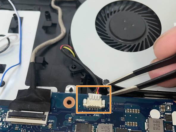

    • Unscrew the four 6 mm Phillips #0 screws that secure the fan.
    • Push the white fan connector directly out of its port using tweezers or a pry tool.
    • Lift the fan up and out of the chassis.
