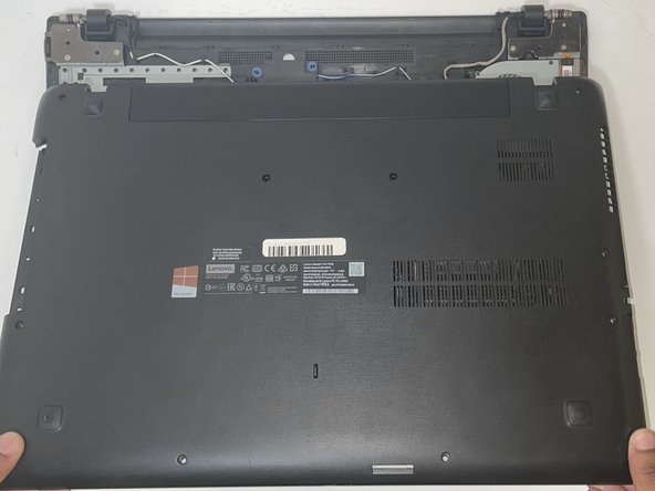

    • Place the the computer bottom facing up. Unscrew the eleven Phillips #0 6 mm screws.

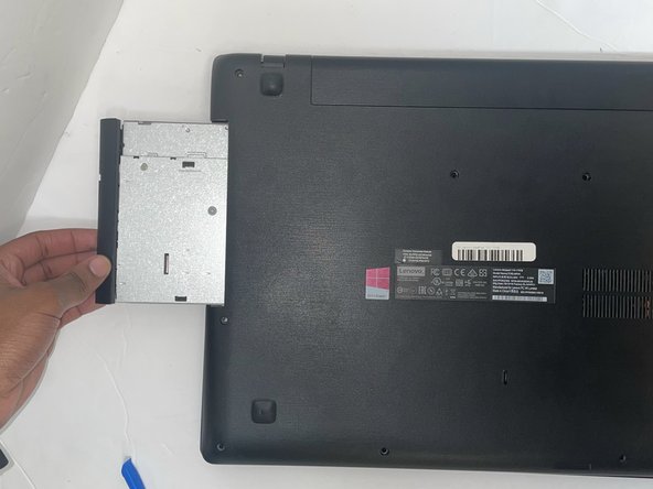

    • Pry the disk drive opposite of the laptop.
    • Since the screws has already been removed, you will not need to worry about any more screws on the optical drive.

    • Release any of the remaining retaining clips and remove the lower case.

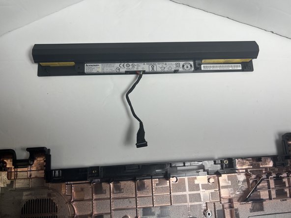

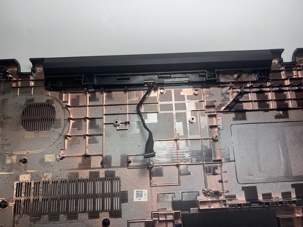

    • Remove the two 9 mm Phillips #0 screws that secure the battery.
    • Remove the battery from the device.
