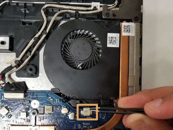

  8. Lenovo IdeaPad 110-15ISK Cooling Fan Replacement, Cooling Fan: crwdns2935265:09crwdnd2935265:01crwdnd2935265:02crwdne2935265:0 Lenovo IdeaPad 110-15ISK Cooling Fan Replacement, Cooling Fan: crwdns2935265:09crwdnd2935265:02crwdnd2935265:02crwdne2935265:0
    • On the back panel, the cooling fan is located at the top right.
    • Unscrew the 6.0mm screw using the Phillips #1 screwdriver.
    • Push the plastic piece towards the direction the wires are in with the tweezers to completely disconnect it from the back panel.
