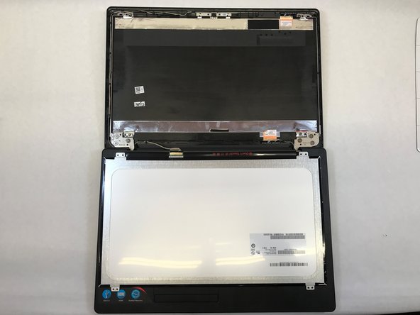

  3. Lenovo IdeaPad 110-15IBR Display Replacement: crwdns2935265:03crwdnd2935265:01crwdnd2935265:02crwdne2935265:0 Lenovo IdeaPad 110-15IBR Display Replacement: crwdns2935265:03crwdnd2935265:02crwdnd2935265:02crwdne2935265:0
    • Carefully lay the screen facing down on the keyboard.
    • Careful not to lift the screen to high up or tug on the screen due to a wire still being connected to the screen and display.

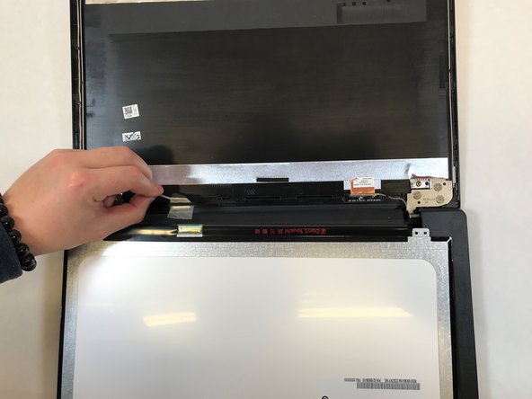

  4. Lenovo IdeaPad 110-15IBR Display Replacement: crwdns2935265:04crwdnd2935265:01crwdnd2935265:02crwdne2935265:0 Lenovo IdeaPad 110-15IBR Display Replacement: crwdns2935265:04crwdnd2935265:02crwdnd2935265:02crwdne2935265:0
    • Remove the tape holding the connected wire to the display.
    • Gently remove the display wire from the connection.
    • Remove the display from the device.
