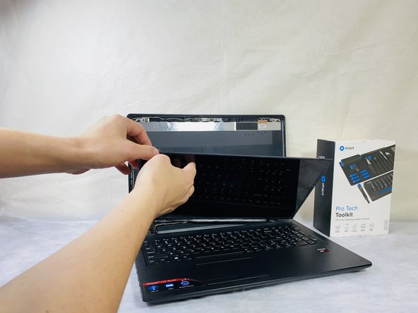

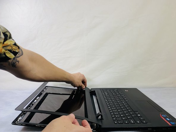

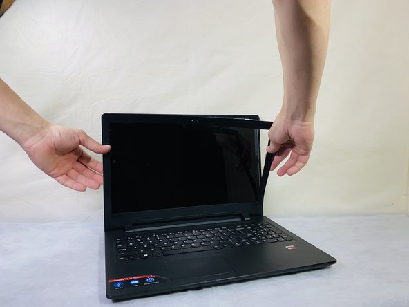

  7. Lenovo IdeaPad 110 Touch-15ACL Screen Replacement, Screen Replacement: crwdns2935265:07crwdnd2935265:01crwdnd2935265:03crwdne2935265:0 Lenovo IdeaPad 110 Touch-15ACL Screen Replacement, Screen Replacement: crwdns2935265:07crwdnd2935265:02crwdnd2935265:03crwdne2935265:0 Lenovo IdeaPad 110 Touch-15ACL Screen Replacement, Screen Replacement: crwdns2935265:07crwdnd2935265:03crwdnd2935265:03crwdne2935265:0
    • Open the laptop so the screen is facing you.
    • Use a pick or spudger to detach the clips around the screen holding the bezel in place.
    • Remove the bezel.

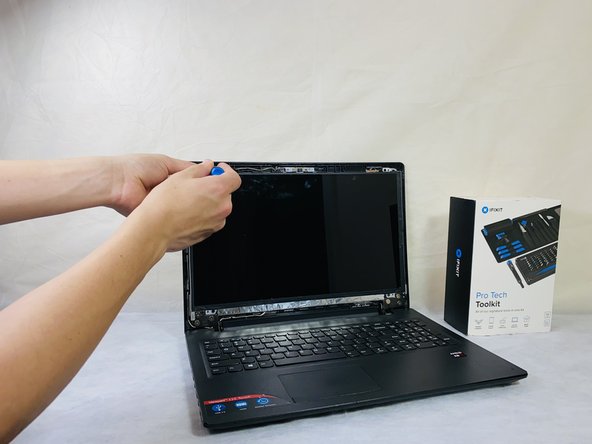

  8. Lenovo IdeaPad 110 Touch-15ACL Screen Replacement: crwdns2935265:08crwdnd2935265:01crwdnd2935265:03crwdne2935265:0 Lenovo IdeaPad 110 Touch-15ACL Screen Replacement: crwdns2935265:08crwdnd2935265:02crwdnd2935265:03crwdne2935265:0 Lenovo IdeaPad 110 Touch-15ACL Screen Replacement: crwdns2935265:08crwdnd2935265:03crwdnd2935265:03crwdne2935265:0
    • Remove the four 3 mm size Phillips #0 mounting screws.

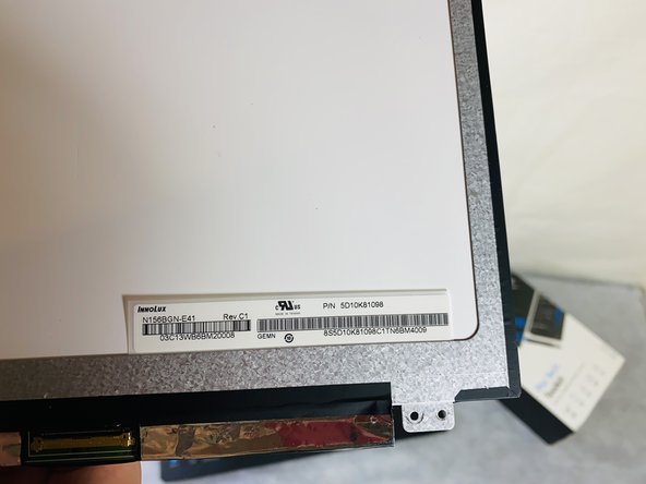

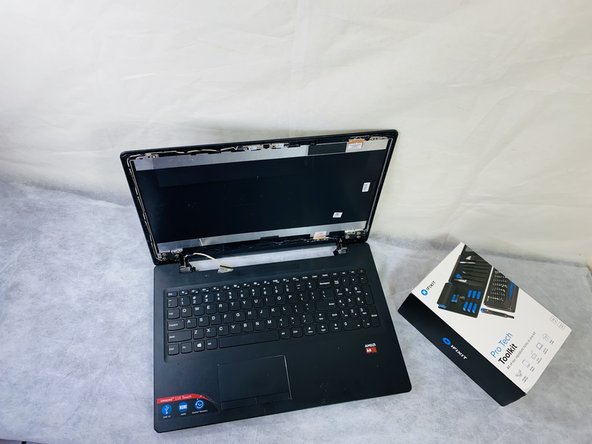

  9. Lenovo IdeaPad 110 Touch-15ACL Screen Replacement: crwdns2935265:09crwdnd2935265:01crwdnd2935265:03crwdne2935265:0 Lenovo IdeaPad 110 Touch-15ACL Screen Replacement: crwdns2935265:09crwdnd2935265:02crwdnd2935265:03crwdne2935265:0 Lenovo IdeaPad 110 Touch-15ACL Screen Replacement: crwdns2935265:09crwdnd2935265:03crwdnd2935265:03crwdne2935265:0
    • Carefully detach the display cable that attaches to the display.
    • There may be a piece of tape covering the connection. Be sure to preserve this if possible—it ensures a proper connection to your display.
