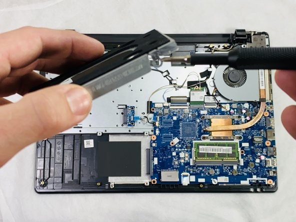

  9. Lenovo IdeaPad 110 Touch-15ACL Motherboard Replacement, Speaker Replacement: crwdns2935265:09crwdnd2935265:01crwdnd2935265:02crwdne2935265:0 Lenovo IdeaPad 110 Touch-15ACL Motherboard Replacement, Speaker Replacement: crwdns2935265:09crwdnd2935265:02crwdnd2935265:02crwdne2935265:0
    • Detach the speaker wire from the motherboard.
  10. Lenovo IdeaPad 110 Touch-15ACL Motherboard Replacement: crwdns2935265:010crwdnd2935265:01crwdnd2935265:02crwdne2935265:0 Lenovo IdeaPad 110 Touch-15ACL Motherboard Replacement: crwdns2935265:010crwdnd2935265:02crwdnd2935265:02crwdne2935265:0
    • Gently pull upwards on the speaker assembly to remove it from the case.

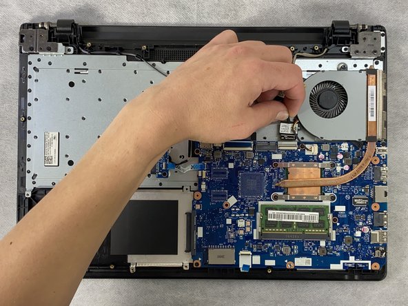

    • Unlock the ZIF connector and remove the wire connected at the bottom of the motherboard.
    • For the wires with the blue plastic, you must undo the clip before pulling out the wire.

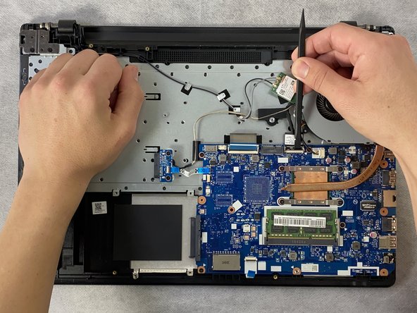

  12. Lenovo IdeaPad 110 Touch-15ACL Motherboard Replacement: crwdns2935265:012crwdnd2935265:01crwdnd2935265:03crwdne2935265:0 Lenovo IdeaPad 110 Touch-15ACL Motherboard Replacement: crwdns2935265:012crwdnd2935265:02crwdnd2935265:03crwdne2935265:0 Lenovo IdeaPad 110 Touch-15ACL Motherboard Replacement: crwdns2935265:012crwdnd2935265:03crwdnd2935265:03crwdne2935265:0
    • Disconnect the wires attached on the "left" side.
    • Use the spudger to unlock the clip to remove the blue ribbon cable.
  13. Lenovo IdeaPad 110 Touch-15ACL Motherboard Replacement: crwdns2935265:013crwdnd2935265:01crwdnd2935265:03crwdne2935265:0 Lenovo IdeaPad 110 Touch-15ACL Motherboard Replacement: crwdns2935265:013crwdnd2935265:02crwdnd2935265:03crwdne2935265:0 Lenovo IdeaPad 110 Touch-15ACL Motherboard Replacement: crwdns2935265:013crwdnd2935265:03crwdnd2935265:03crwdne2935265:0
    • Unlock the ZIF connector at the top-left of the motherboard.
    • Remove the ribbon cable.

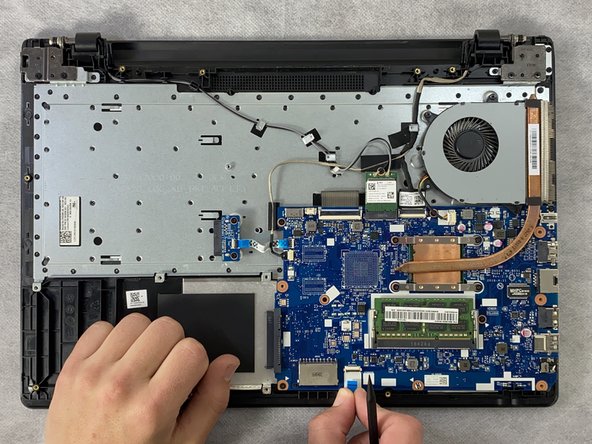

  14. Lenovo IdeaPad 110 Touch-15ACL Motherboard Replacement: crwdns2935265:014crwdnd2935265:01crwdnd2935265:03crwdne2935265:0 Lenovo IdeaPad 110 Touch-15ACL Motherboard Replacement: crwdns2935265:014crwdnd2935265:02crwdnd2935265:03crwdne2935265:0 Lenovo IdeaPad 110 Touch-15ACL Motherboard Replacement: crwdns2935265:014crwdnd2935265:03crwdnd2935265:03crwdne2935265:0

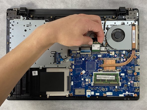

    • Remove the single 4 mm Philips #0 screw from the Wi-Fi card.
    • Slide the Wi-Fi card out of the socket.

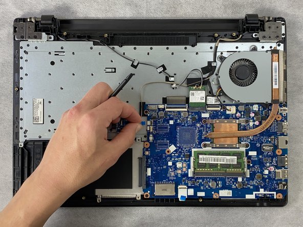

  15. Lenovo IdeaPad 110 Touch-15ACL Motherboard Replacement: crwdns2935265:015crwdnd2935265:01crwdnd2935265:03crwdne2935265:0 Lenovo IdeaPad 110 Touch-15ACL Motherboard Replacement: crwdns2935265:015crwdnd2935265:02crwdnd2935265:03crwdne2935265:0 Lenovo IdeaPad 110 Touch-15ACL Motherboard Replacement: crwdns2935265:015crwdnd2935265:03crwdnd2935265:03crwdne2935265:0
    • Unlock the remaining ZIF connector with a spudger.

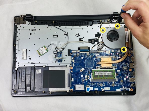

  16. Lenovo IdeaPad 110 Touch-15ACL Motherboard Replacement: crwdns2935265:016crwdnd2935265:01crwdnd2935265:03crwdne2935265:0 Lenovo IdeaPad 110 Touch-15ACL Motherboard Replacement: crwdns2935265:016crwdnd2935265:02crwdnd2935265:03crwdne2935265:0 Lenovo IdeaPad 110 Touch-15ACL Motherboard Replacement: crwdns2935265:016crwdnd2935265:03crwdnd2935265:03crwdne2935265:0

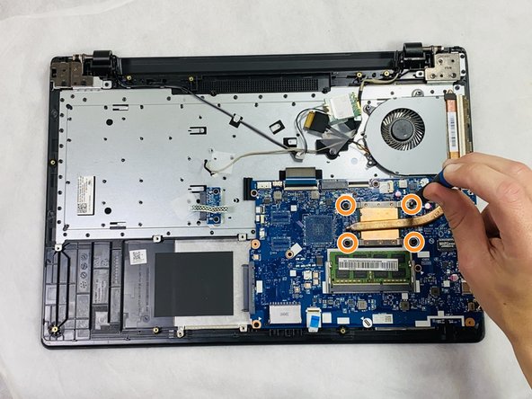

    • Disconnect the fan's wire from the motherboard.
    • Remove the four 3 mm Philips #0 screws joining the heatsink to the motherboard
    • Follow the number order when re-installing.
    • Then, remove the three 5 mm Philips #0 screws holding the fan assembly to the frame.
    • Remove the fan and heatsink.

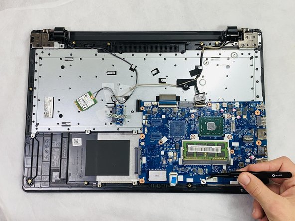

  18. Lenovo IdeaPad 110 Touch-15ACL Motherboard Replacement: crwdns2935265:018crwdnd2935265:01crwdnd2935265:01crwdne2935265:0
    • This is what the frame should look like once everything is removed.
