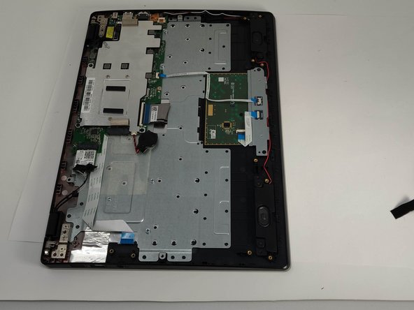

Lenovo IdeaPad 100s-14IBR USB/Headphones Jack Replacement
  1. Lenovo IdeaPad 100s-14IBR USB/Headphones Jack Replacement, USB/Headphones Jack: crwdns2935265:01crwdnd2935265:01crwdnd2935265:01crwdne2935265:0
    • Remove the eight 4mm PH00 screws.
    • Remove the four 2mm PH00 screws.
  2. Lenovo IdeaPad 100s-14IBR USB/Headphones Jack Replacement: crwdns2935265:02crwdnd2935265:01crwdnd2935265:02crwdne2935265:0 Lenovo IdeaPad 100s-14IBR USB/Headphones Jack Replacement: crwdns2935265:02crwdnd2935265:02crwdnd2935265:02crwdne2935265:0
    • Use the nylon spudger to loosen the back cover from the back of the device.
    • You may hear a bit of a snapping sound, but this is normal.
  3. Lenovo IdeaPad 100s-14IBR USB/Headphones Jack Replacement: crwdns2935265:03crwdnd2935265:01crwdnd2935265:01crwdne2935265:0
    • For safety reasons, disconnect the wires connecting the battery to the motherboard with the nylon spudger.
  4. Lenovo IdeaPad 100s-14IBR USB/Headphones Jack Replacement: crwdns2935265:04crwdnd2935265:01crwdnd2935265:01crwdne2935265:0
    • Remove the three 4mm PH00 screws.
    • Unplug the ribbon wire connected to the USB/Headphone Jack PCB by lifting the black plastic tab holding the ribbon cable down.
    • Be extra careful not to bend the ribbon cable too much as it is fragile.
  5. Lenovo IdeaPad 100s-14IBR USB/Headphones Jack Replacement: crwdns2935265:05crwdnd2935265:01crwdnd2935265:02crwdne2935265:0 Lenovo IdeaPad 100s-14IBR USB/Headphones Jack Replacement: crwdns2935265:05crwdnd2935265:02crwdnd2935265:02crwdne2935265:0
    • Lift the USB/Headphone Jack PCB off of the board gently and put it to the side.
