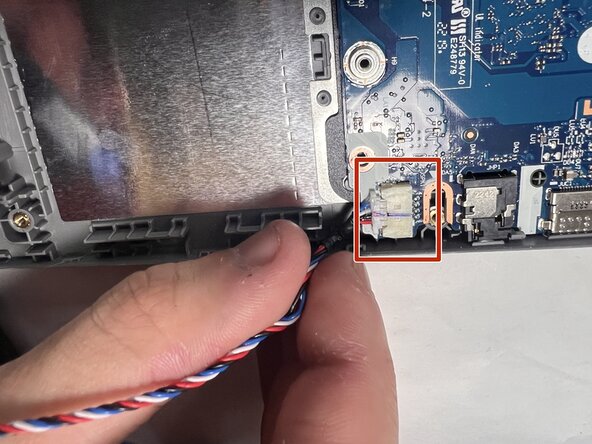

  10. Lenovo IdeaPad 1 14IGL7 Speakers Replacement: crwdns2935265:010crwdnd2935265:01crwdnd2935265:01crwdne2935265:0
    • Gently pull on the wire that connects the speakers to the motherboard.
    • Pull the cable away from the connector in the same direction as the individual wires are running.
    • Pull evenly on the full width of the cable so that no individual wires are overly strained.

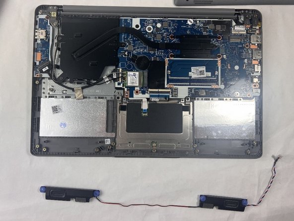

  11. Lenovo IdeaPad 1 14IGL7 Speakers Replacement: crwdns2935265:011crwdnd2935265:01crwdnd2935265:02crwdne2935265:0 Lenovo IdeaPad 1 14IGL7 Speakers Replacement: crwdns2935265:011crwdnd2935265:02crwdnd2935265:02crwdne2935265:0
    • For each of the two speakers, remove each end separately from the device.
