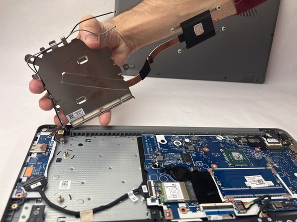

  4. Lenovo IdeaPad 1 14IGL7 Fan Replacement, Fan: crwdns2935265:04crwdnd2935265:01crwdnd2935265:01crwdne2935265:0
    • Remove the seven 5.5 mm screws that secure the fan using a Phillips #00 screwdriver.
  5. Lenovo IdeaPad 1 14IGL7 Fan Replacement: crwdns2935265:05crwdnd2935265:01crwdnd2935265:02crwdne2935265:0 Lenovo IdeaPad 1 14IGL7 Fan Replacement: crwdns2935265:05crwdnd2935265:02crwdnd2935265:02crwdne2935265:0
    • Place your fingers on the perimeter of the fan and gently lift it away from the device.
