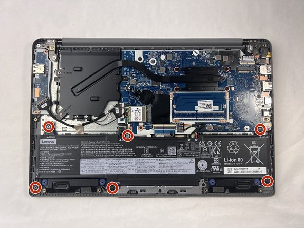

  4. Lenovo IdeaPad 1 14IGL7 Battery Replacement, Battery: crwdns2935265:04crwdnd2935265:01crwdnd2935265:02crwdne2935265:0 Lenovo IdeaPad 1 14IGL7 Battery Replacement, Battery: crwdns2935265:04crwdnd2935265:02crwdnd2935265:02crwdne2935265:0
    • Remove the six 5.5 mm screws that secure the battery using a Phillips #00 screwdriver.

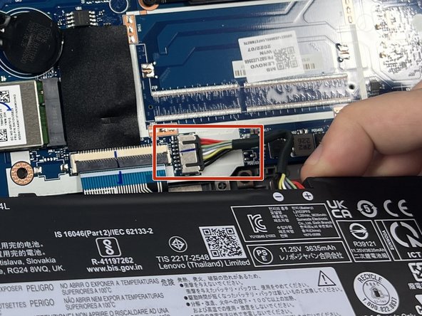

  5. Lenovo IdeaPad 1 14IGL7 Battery Replacement: crwdns2935265:05crwdnd2935265:01crwdnd2935265:02crwdne2935265:0 Lenovo IdeaPad 1 14IGL7 Battery Replacement: crwdns2935265:05crwdnd2935265:02crwdnd2935265:02crwdne2935265:0
    • Gently pull on the cable attached to the motherboard in the same direction as the individual wires are running.
    • Be sure to ground yourself by wearing the anti-shock wristband to prevent damage to the components.
    • Pull evenly on the full width of the cable so that no individual wires are overly strained.
  6. Lenovo IdeaPad 1 14IGL7 Battery Replacement: crwdns2935265:06crwdnd2935265:01crwdnd2935265:01crwdne2935265:0
    • Remove the battery.
