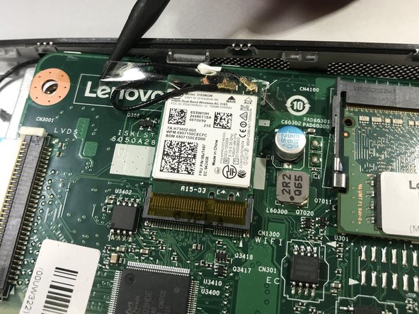

  9. Lenovo IdeaCentre AIO 510S-23ISU WiFi Card Replacement, WiFi Card: crwdns2935265:09crwdnd2935265:01crwdnd2935265:02crwdne2935265:0 Lenovo IdeaCentre AIO 510S-23ISU WiFi Card Replacement, WiFi Card: crwdns2935265:09crwdnd2935265:02crwdnd2935265:02crwdne2935265:0
    • Remove any tape that secures the WiFi antenna cables.
  10. Lenovo IdeaCentre AIO 510S-23ISU WiFi Card Replacement: crwdns2935265:010crwdnd2935265:01crwdnd2935265:02crwdne2935265:0 Lenovo IdeaCentre AIO 510S-23ISU WiFi Card Replacement: crwdns2935265:010crwdnd2935265:02crwdnd2935265:02crwdne2935265:0
    • Remove the single screw that secures that WiFi card to the motherboard.
  11. Lenovo IdeaCentre AIO 510S-23ISU WiFi Card Replacement: crwdns2935265:011crwdnd2935265:01crwdnd2935265:02crwdne2935265:0 Lenovo IdeaCentre AIO 510S-23ISU WiFi Card Replacement: crwdns2935265:011crwdnd2935265:02crwdnd2935265:02crwdne2935265:0
    • Lift the wifi card and then pull out the card.
  12. Lenovo IdeaCentre AIO 510S-23ISU WiFi Card Replacement: crwdns2935265:012crwdnd2935265:01crwdnd2935265:01crwdne2935265:0
    • Locate the two small cables connected to the wifi card and pull gently to disconnect them.
