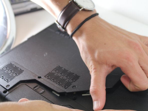

    • Turn off the computer.
    • Slide the battery-lock switch on the bottom of the laptop to the unlocked position.
  2. Lenovo G780 Heat Sink Replacement: crwdns2935265:02crwdnd2935265:01crwdnd2935265:01crwdne2935265:0
    • Hold the battery release switch in the unlocked position and remove the battery.

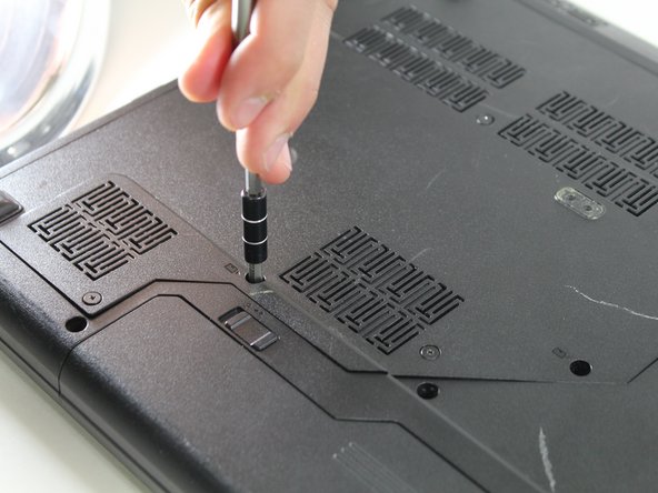

  3. Lenovo G780 Heat Sink Replacement, Fan: crwdns2935265:03crwdnd2935265:01crwdnd2935265:03crwdne2935265:0 Lenovo G780 Heat Sink Replacement, Fan: crwdns2935265:03crwdnd2935265:02crwdnd2935265:03crwdne2935265:0 Lenovo G780 Heat Sink Replacement, Fan: crwdns2935265:03crwdnd2935265:03crwdnd2935265:03crwdne2935265:0
    • Remove the six 9 mm screws from the back panel with a Phillips #0 screwdriver.
    • Save these screws.
    • Remove the back plate.
