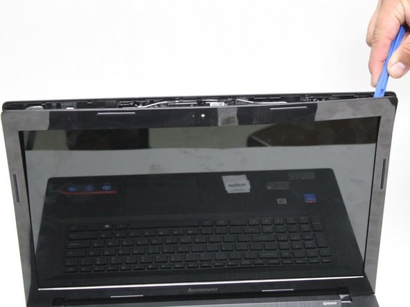

  6. Lenovo G70-80 Screen Replacement: crwdns2935265:06crwdnd2935265:01crwdnd2935265:03crwdne2935265:0 Lenovo G70-80 Screen Replacement: crwdns2935265:06crwdnd2935265:02crwdnd2935265:03crwdne2935265:0 Lenovo G70-80 Screen Replacement: crwdns2935265:06crwdnd2935265:03crwdnd2935265:03crwdne2935265:0
    • Use a plastic opening tool to pull the bezel forward and release it from the top of the LCD panel.
    • The bezel is the plastic frame around the laptop screen.

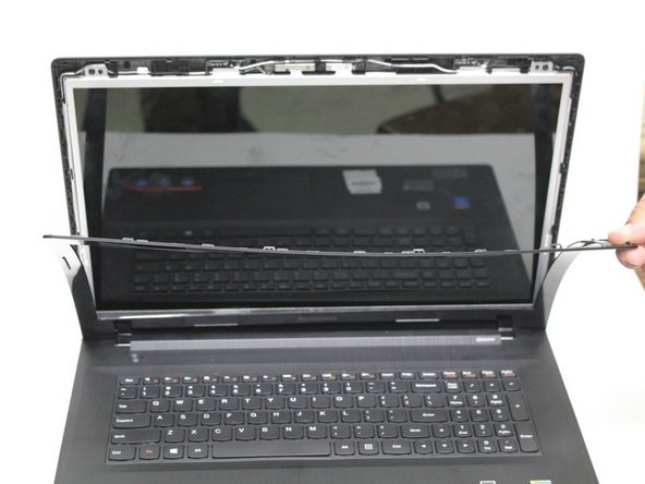

  7. Lenovo G70-80 Screen Replacement: crwdns2935265:07crwdnd2935265:01crwdnd2935265:02crwdne2935265:0 Lenovo G70-80 Screen Replacement: crwdns2935265:07crwdnd2935265:02crwdnd2935265:02crwdne2935265:0
    • After the top part of the bezel is released, use the plastic opening tool to completely remove the bezel.
    • If you are having trouble removing the bezel from the LCD panel, pull both sides of the bezel towards you with your hands.

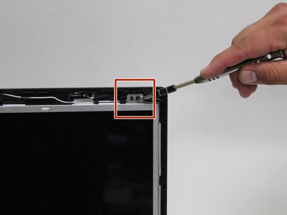

  8. Lenovo G70-80 Screen Replacement: crwdns2935265:08crwdnd2935265:01crwdnd2935265:03crwdne2935265:0 Lenovo G70-80 Screen Replacement: crwdns2935265:08crwdnd2935265:02crwdnd2935265:03crwdne2935265:0 Lenovo G70-80 Screen Replacement: crwdns2935265:08crwdnd2935265:03crwdnd2935265:03crwdne2935265:0
    • Use a screwdriver to remove the screws that secure the LCD panel to the computer.
    • Once the bezel is removed, you will see eight screws around the screen that secure the LCD panel to the computer.

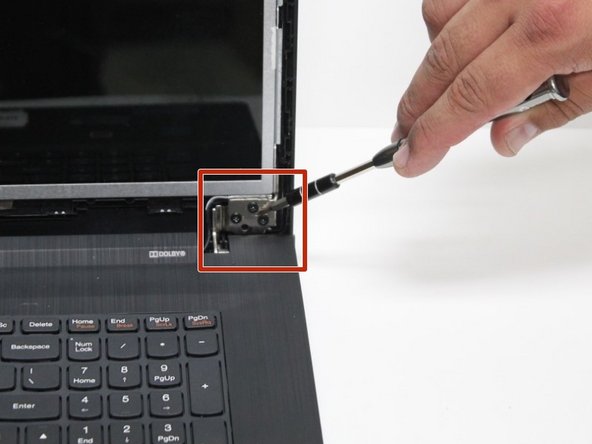

  11. Lenovo G70-80 Screen Replacement: crwdns2935265:011crwdnd2935265:01crwdnd2935265:02crwdne2935265:0 Lenovo G70-80 Screen Replacement: crwdns2935265:011crwdnd2935265:02crwdnd2935265:02crwdne2935265:0
    • With a screwdriver, remove the four screws that mount the LCD panel onto the mounting arms.
    • There is one screw on each corner that connects to the mounting arms.
