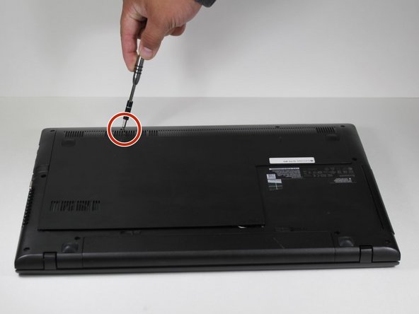

    • Turn off the computer.
    • Set the computer upside down with the back facing up.
  2. Lenovo G70-80 RAM Replacement: crwdns2935265:02crwdnd2935265:01crwdnd2935265:02crwdne2935265:0 Lenovo G70-80 RAM Replacement: crwdns2935265:02crwdnd2935265:02crwdnd2935265:02crwdne2935265:0
    • Located directly below the bottom plate will be two switches near where the battery is located.
    • With the battery facing you, slide the battery switch on the right side of the laptop towards the right.
    • To ensure the switch on the right is unlocked, look for a red indicator next to the switch.
  3. Lenovo G70-80 RAM Replacement: crwdns2935265:03crwdnd2935265:01crwdnd2935265:02crwdne2935265:0 Lenovo G70-80 RAM Replacement: crwdns2935265:03crwdnd2935265:02crwdnd2935265:02crwdne2935265:0
    • Slide the left battery release switch to the left.
    • While holding the switch to the left, lift the battery to remove it from the computer.
  4. Lenovo G70-80 RAM Replacement: crwdns2935265:04crwdnd2935265:01crwdnd2935265:02crwdne2935265:0 Lenovo G70-80 RAM Replacement: crwdns2935265:04crwdnd2935265:02crwdnd2935265:02crwdne2935265:0
    • Remove the battery.
  5. Lenovo G70-80 RAM Replacement, RAM: crwdns2935265:05crwdnd2935265:01crwdnd2935265:03crwdne2935265:0 Lenovo G70-80 RAM Replacement, RAM: crwdns2935265:05crwdnd2935265:02crwdnd2935265:03crwdne2935265:0 Lenovo G70-80 RAM Replacement, RAM: crwdns2935265:05crwdnd2935265:03crwdnd2935265:03crwdne2935265:0
    • Remove the placeholder screws and pull off the backplate.
  6. Lenovo G70-80 RAM Replacement: crwdns2935265:06crwdnd2935265:01crwdnd2935265:03crwdne2935265:0 Lenovo G70-80 RAM Replacement: crwdns2935265:06crwdnd2935265:02crwdnd2935265:03crwdne2935265:0 Lenovo G70-80 RAM Replacement: crwdns2935265:06crwdnd2935265:03crwdnd2935265:03crwdne2935265:0
    • Carefully pull the two metal retaining clips away from the sides of the RAM module.
    • As the clips release, the RAM module should pop up at an angle.
    • Remove the RAM from the device.
