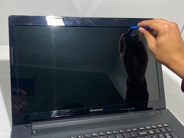

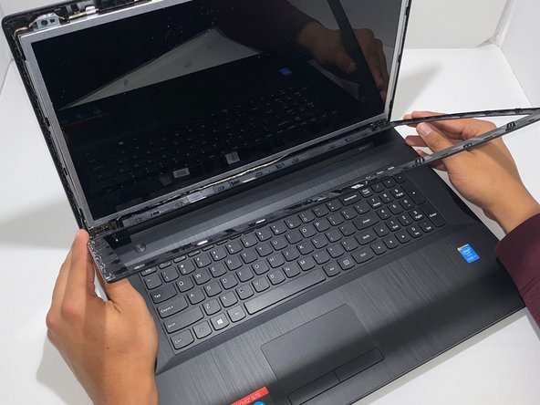

  4. Lenovo G70-70 Webcam Replacement, Webcam: crwdns2935265:04crwdnd2935265:01crwdnd2935265:03crwdne2935265:0 Lenovo G70-70 Webcam Replacement, Webcam: crwdns2935265:04crwdnd2935265:02crwdnd2935265:03crwdne2935265:0 Lenovo G70-70 Webcam Replacement, Webcam: crwdns2935265:04crwdnd2935265:03crwdnd2935265:03crwdne2935265:0
    • Pry open the plastic casing surrounding the screen with the opening tool.
    • You will hear loud popping noises as you separate the plastic casing from the screen.
    • Pull the plastic casing toward yourself and separate it from the screen.

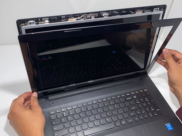

  5. Lenovo G70-70 Webcam Replacement: crwdns2935265:05crwdnd2935265:01crwdnd2935265:03crwdne2935265:0 Lenovo G70-70 Webcam Replacement: crwdns2935265:05crwdnd2935265:02crwdnd2935265:03crwdne2935265:0 Lenovo G70-70 Webcam Replacement: crwdns2935265:05crwdnd2935265:03crwdnd2935265:03crwdne2935265:0
    • Pull the plastic casing upward and toward yourself to completely remove it from the laptop.

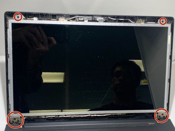

    • Remove eight 4.5 mm screws from the front of the metal casing with a Phillips #0 screwdriver.
    • There are three screws on the bottom left and right sides of the screen. There is one screw on the top left and right side of the screen.

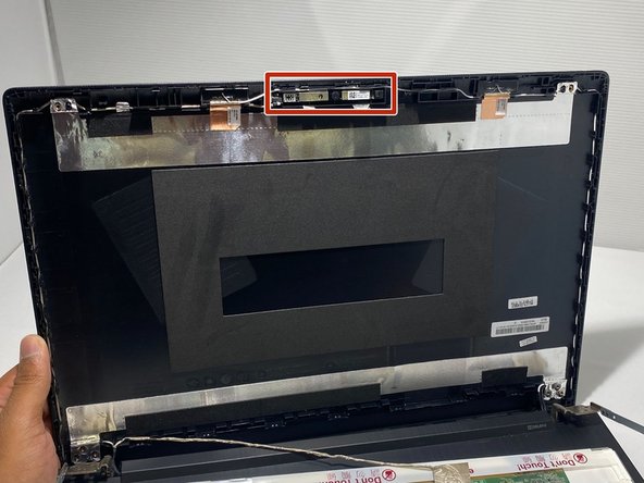

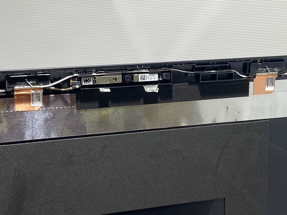

  6. Lenovo G70-70 Webcam Replacement: crwdns2935265:06crwdnd2935265:01crwdnd2935265:02crwdne2935265:0 Lenovo G70-70 Webcam Replacement: crwdns2935265:06crwdnd2935265:02crwdnd2935265:02crwdne2935265:0
    • Lower the screen to separate it from the plastic casing behind it.
    • The webcam will be located at the top of the back casing.

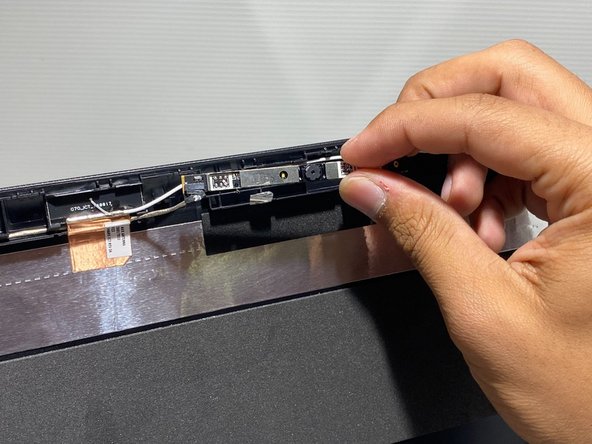

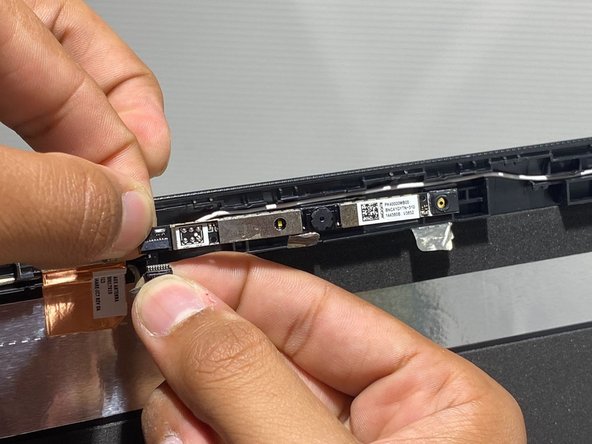

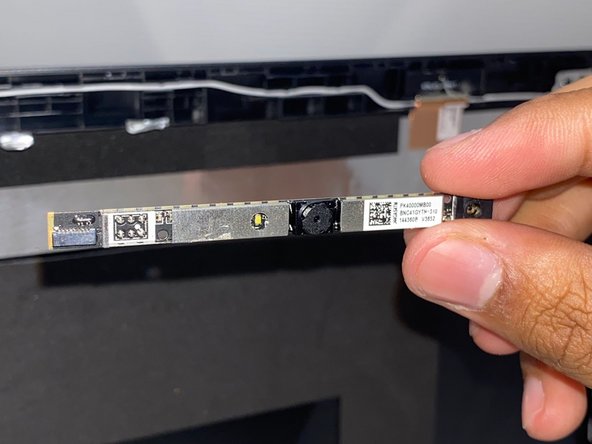

  7. Lenovo G70-70 Webcam Replacement: crwdns2935265:07crwdnd2935265:01crwdnd2935265:03crwdne2935265:0 Lenovo G70-70 Webcam Replacement: crwdns2935265:07crwdnd2935265:02crwdnd2935265:03crwdne2935265:0 Lenovo G70-70 Webcam Replacement: crwdns2935265:07crwdnd2935265:03crwdnd2935265:03crwdne2935265:0
    • Pull the silver flaps down to access the webcam.
    • Pull the webcam out of the plastic casing to gain access to its cable.
  8. Lenovo G70-70 Webcam Replacement: crwdns2935265:08crwdnd2935265:01crwdnd2935265:03crwdne2935265:0 Lenovo G70-70 Webcam Replacement: crwdns2935265:08crwdnd2935265:02crwdnd2935265:03crwdne2935265:0 Lenovo G70-70 Webcam Replacement: crwdns2935265:08crwdnd2935265:03crwdnd2935265:03crwdne2935265:0
    • Pull the cable down to remove the webcam from the laptop.
