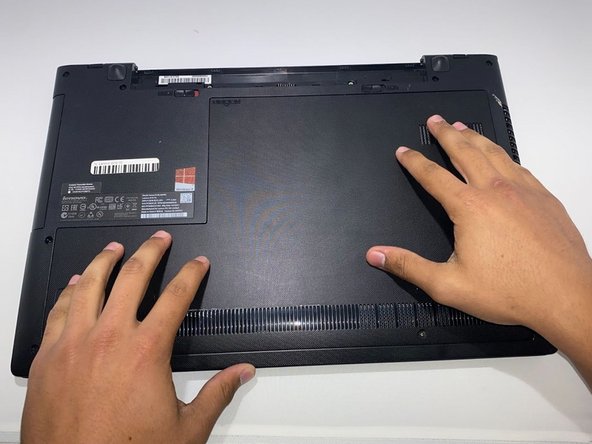

      • Ensure the battery is removed before attempting to fix anything on the laptop.
      • Orient the laptop so the bottom side is facing you.
      • To unlock the battery, place your thumb over the left switch and slide it to the left.
    2. Lenovo G70-70 Keyboard Replacement: crwdns2935265:02crwdnd2935265:01crwdnd2935265:02crwdne2935265:0 Lenovo G70-70 Keyboard Replacement: crwdns2935265:02crwdnd2935265:02crwdnd2935265:02crwdne2935265:0
      • To access the battery, place your thumb over the right switch and slide it to the right.
      • When the battery is unlocked, it will automatically pop up.
    3. Lenovo G70-70 Keyboard Replacement: crwdns2935265:03crwdnd2935265:01crwdnd2935265:03crwdne2935265:0 Lenovo G70-70 Keyboard Replacement: crwdns2935265:03crwdnd2935265:02crwdnd2935265:03crwdne2935265:0 Lenovo G70-70 Keyboard Replacement: crwdns2935265:03crwdnd2935265:03crwdnd2935265:03crwdne2935265:0
      • Remove the battery by lifting it up and away from yourself.

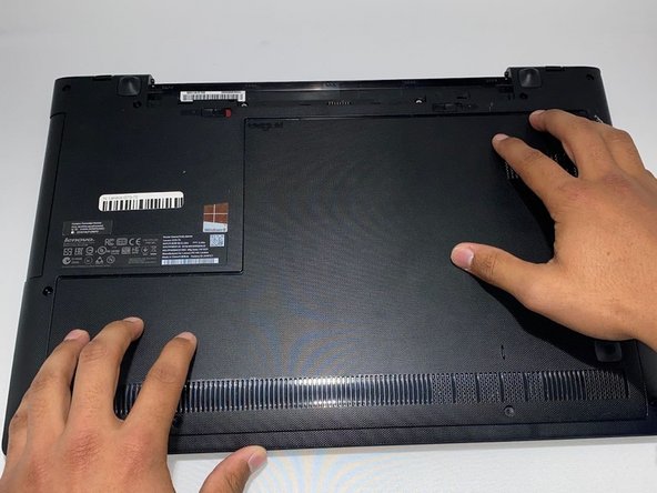

    1. Lenovo G70-70 Keyboard Replacement, Keyboard: crwdns2935265:04crwdnd2935265:01crwdnd2935265:03crwdne2935265:0 Lenovo G70-70 Keyboard Replacement, Keyboard: crwdns2935265:04crwdnd2935265:02crwdnd2935265:03crwdne2935265:0 Lenovo G70-70 Keyboard Replacement, Keyboard: crwdns2935265:04crwdnd2935265:03crwdnd2935265:03crwdne2935265:0
      • Turn your laptop so the bottom side is facing you.
      • Remove two 7.3 mm Phillips #0 screws.
      • Slide the back cover towards yourself.

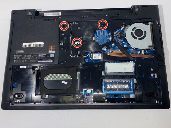

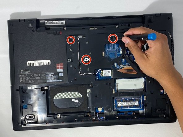

    2. Lenovo G70-70 Keyboard Replacement: crwdns2935265:05crwdnd2935265:01crwdnd2935265:03crwdne2935265:0 Lenovo G70-70 Keyboard Replacement: crwdns2935265:05crwdnd2935265:02crwdnd2935265:03crwdne2935265:0 Lenovo G70-70 Keyboard Replacement: crwdns2935265:05crwdnd2935265:03crwdnd2935265:03crwdne2935265:0
      • Lift the back cover from the far side towards yourself to remove it.
      • Remove three 6.2 mm Phillips #0 screws.
      • The label M2X6 is written next to each screw that keeps the keyboard secure.

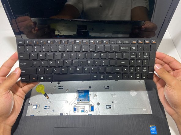

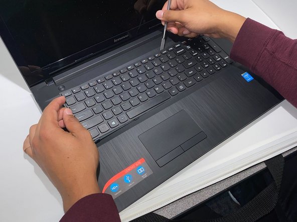

    3. Lenovo G70-70 Keyboard Replacement: crwdns2935265:06crwdnd2935265:01crwdnd2935265:03crwdne2935265:0 Lenovo G70-70 Keyboard Replacement: crwdns2935265:06crwdnd2935265:02crwdnd2935265:03crwdne2935265:0 Lenovo G70-70 Keyboard Replacement: crwdns2935265:06crwdnd2935265:03crwdnd2935265:03crwdne2935265:0
      • Turn the laptop over so the top side is facing you and open the laptop.
      • Carefully pry open any corner of the keyboard with the metal spudger.
      • Slide the metal spudger around the perimeter of the keyboard until you can lift it.
      • You will hear loud popping noises as the keyboard separates from the laptop.

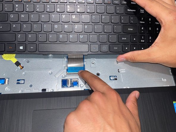

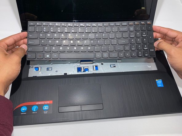

    4. Lenovo G70-70 Keyboard Replacement: crwdns2935265:07crwdnd2935265:01crwdnd2935265:02crwdne2935265:0 Lenovo G70-70 Keyboard Replacement: crwdns2935265:07crwdnd2935265:02crwdnd2935265:02crwdne2935265:0
      • Carefully lift the keyboard.
      • Use your finger or the opening tool to pull the locking flap toward yourself.
    5. Lenovo G70-70 Keyboard Replacement: crwdns2935265:08crwdnd2935265:01crwdnd2935265:02crwdne2935265:0 Lenovo G70-70 Keyboard Replacement: crwdns2935265:08crwdnd2935265:02crwdnd2935265:02crwdne2935265:0
      • Pull the silver ribbon cable away from you to disconnect the keyboard.
      • Remove the keyboard from the laptop.
