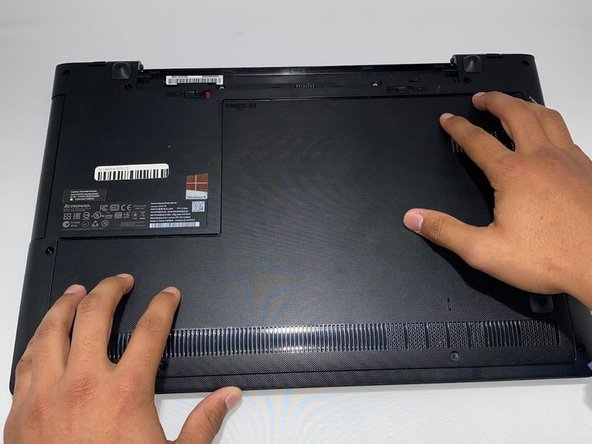

  4. Lenovo G70-70 Fan Replacement, Fan: crwdns2935265:04crwdnd2935265:01crwdnd2935265:03crwdne2935265:0 Lenovo G70-70 Fan Replacement, Fan: crwdns2935265:04crwdnd2935265:02crwdnd2935265:03crwdne2935265:0 Lenovo G70-70 Fan Replacement, Fan: crwdns2935265:04crwdnd2935265:03crwdnd2935265:03crwdne2935265:0
    • Turn your laptop so the bottom side is facing you.
    • Remove two 7.3 mm Phillips #0 screws.
    • Slide the back cover towards yourself.

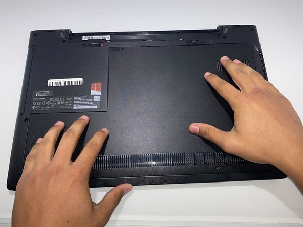

  5. Lenovo G70-70 Fan Replacement: crwdns2935265:05crwdnd2935265:01crwdnd2935265:03crwdne2935265:0 Lenovo G70-70 Fan Replacement: crwdns2935265:05crwdnd2935265:02crwdnd2935265:03crwdne2935265:0 Lenovo G70-70 Fan Replacement: crwdns2935265:05crwdnd2935265:03crwdnd2935265:03crwdne2935265:0
    • Lift the back cover from the far side towards yourself to remove it.

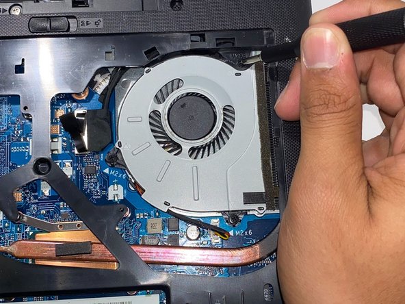

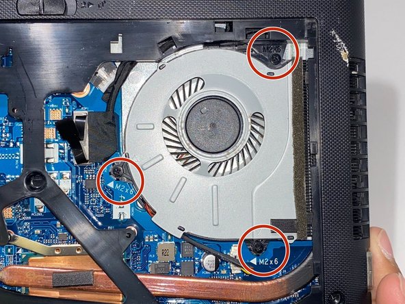

    • Remove three 6.5 mm screws from the fan using a Phillips #0 screwdriver.
    • The label M2X6 will be located next to each screw.

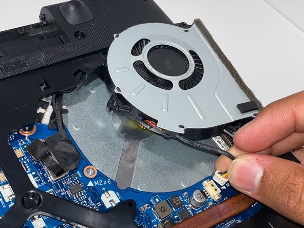

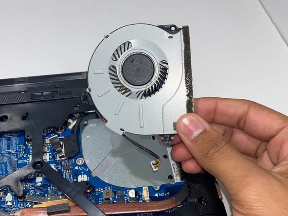

  6. Lenovo G70-70 Fan Replacement: crwdns2935265:06crwdnd2935265:01crwdnd2935265:03crwdne2935265:0 Lenovo G70-70 Fan Replacement: crwdns2935265:06crwdnd2935265:02crwdnd2935265:03crwdne2935265:0 Lenovo G70-70 Fan Replacement: crwdns2935265:06crwdnd2935265:03crwdnd2935265:03crwdne2935265:0
    • Pinch both sides of the white connector and pull the cord from the socket.
    • Remove the fan from the laptop.
