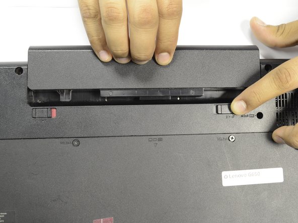

    • Make sure your laptop is oriented backside facing upward as seen in the image.
    • Locate the battery lock switch.
  2. Lenovo G580 Battery Replacement: crwdns2935265:02crwdnd2935265:01crwdnd2935265:02crwdne2935265:0 Lenovo G580 Battery Replacement: crwdns2935265:02crwdnd2935265:02crwdnd2935265:02crwdne2935265:0
    • Unlock the battery by moving the switch to the right.
    • The switch is unlocked when the RED of the switch is present.
  3. Lenovo G580 Battery Replacement: crwdns2935265:03crwdnd2935265:01crwdnd2935265:02crwdne2935265:0 Lenovo G580 Battery Replacement: crwdns2935265:03crwdnd2935265:02crwdnd2935265:02crwdne2935265:0
    • Hold the release switch down.
    • At the same time, push the battery upwards to remove the battery.
    • Pulling on the battery while the battery is locked will damage the laptop. Ensure the lock is properly disengaged.
