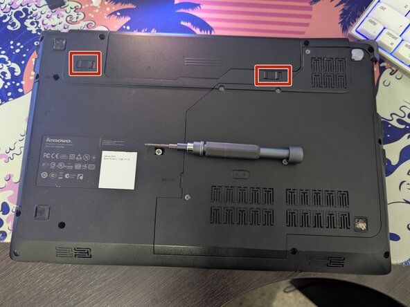

    • Flip your laptop to its back side.
    • At the top of the laptop you will see two switches, keeping the battery in place.

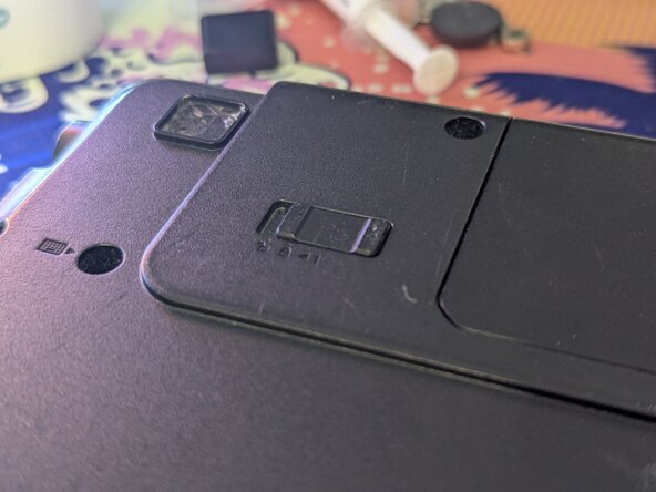

  2. Lenovo G570 Battery Replacement, Left Switch: crwdns2935265:02crwdnd2935265:01crwdnd2935265:03crwdne2935265:0 Lenovo G570 Battery Replacement, Left Switch: crwdns2935265:02crwdnd2935265:02crwdnd2935265:03crwdne2935265:0 Lenovo G570 Battery Replacement, Left Switch: crwdns2935265:02crwdnd2935265:03crwdnd2935265:03crwdne2935265:0
    • Pull the left switch outwards with your thumb, towards the unlocked lock.
  3. Lenovo G570 Battery Replacement, Right Switch: crwdns2935265:03crwdnd2935265:01crwdnd2935265:02crwdne2935265:0 Lenovo G570 Battery Replacement, Right Switch: crwdns2935265:03crwdnd2935265:02crwdnd2935265:02crwdne2935265:0
    • Do the same thing for the right one. Do not remove your thumb now though, as this switch is spring-loaded.
  4. Lenovo G570 Battery Replacement, Battery: crwdns2935265:04crwdnd2935265:01crwdnd2935265:02crwdne2935265:0 Lenovo G570 Battery Replacement, Battery: crwdns2935265:04crwdnd2935265:02crwdnd2935265:02crwdne2935265:0
    • While holding the right switch at the unlocked position, slide the battery out.
