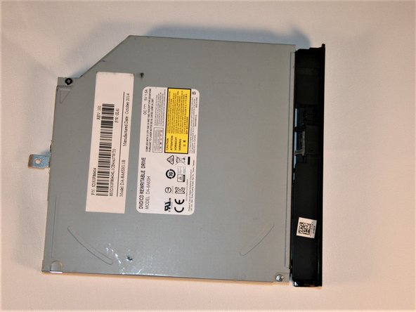

  7. Lenovo G50-80 80E5 Power Supply Jack Replacement, CD Drive: crwdns2935265:07crwdnd2935265:01crwdnd2935265:02crwdne2935265:0 Lenovo G50-80 80E5 Power Supply Jack Replacement, CD Drive: crwdns2935265:07crwdnd2935265:02crwdnd2935265:02crwdne2935265:0
    • Locate the CD drive.
    • Remove the single #00 Phillips 5.5 mm screw on the centermost side of the drive.
  8. Lenovo G50-80 80E5 Power Supply Jack Replacement: crwdns2935265:08crwdnd2935265:01crwdnd2935265:02crwdne2935265:0 Lenovo G50-80 80E5 Power Supply Jack Replacement: crwdns2935265:08crwdnd2935265:02crwdnd2935265:02crwdne2935265:0
    • Move the drive towards the outside of the laptop to remove the connector.
    • Pull the drive out of the laptop.

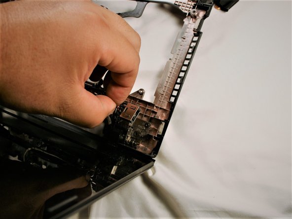

  29. Lenovo G50-80 80E5 Power Supply Jack Replacement, Power Supply Jack: crwdns2935265:029crwdnd2935265:01crwdnd2935265:02crwdne2935265:0 Lenovo G50-80 80E5 Power Supply Jack Replacement, Power Supply Jack: crwdns2935265:029crwdnd2935265:02crwdnd2935265:02crwdne2935265:0
    • lift up power jack and remove from holding tabs
  30. Lenovo G50-80 80E5 Power Supply Jack Replacement: crwdns2935265:030crwdnd2935265:01crwdnd2935265:01crwdne2935265:0
    • power jack removed
