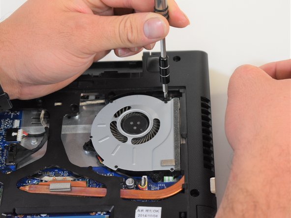

  5. Lenovo G50-70 Fan Replacement, Fan: crwdns2935265:05crwdnd2935265:01crwdnd2935265:02crwdne2935265:0 Lenovo G50-70 Fan Replacement, Fan: crwdns2935265:05crwdnd2935265:02crwdnd2935265:02crwdne2935265:0
    • Remove the three 6mm Phillips #0 screws on the perimeter of the fan.

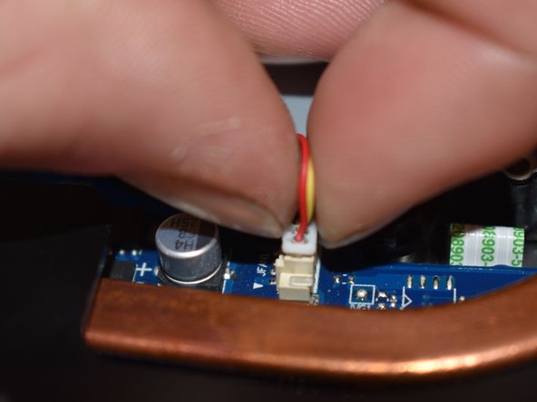

    • The fan is plugged into the motherboard next to the copper heat sync.
    • Unplug the bundled wire connector by pulling up on the white plug.
    • Do not pull up by the wires.
  7. Lenovo G50-70 Fan Replacement: crwdns2935265:07crwdnd2935265:01crwdnd2935265:02crwdne2935265:0 Lenovo G50-70 Fan Replacement: crwdns2935265:07crwdnd2935265:02crwdnd2935265:02crwdne2935265:0
    • Lift fan out of case.
