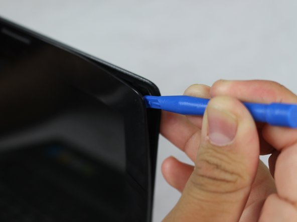

  4. Lenovo G40-30 LCD Screen Replacement, LCD Screen: crwdns2935265:04crwdnd2935265:01crwdnd2935265:02crwdne2935265:0 Lenovo G40-30 LCD Screen Replacement, LCD Screen: crwdns2935265:04crwdnd2935265:02crwdnd2935265:02crwdne2935265:0
    • Use the plastic opening tool to pry the plastic away from the screen.
  5. Lenovo G40-30 LCD Screen Replacement: crwdns2935265:05crwdnd2935265:01crwdnd2935265:02crwdne2935265:0 Lenovo G40-30 LCD Screen Replacement: crwdns2935265:05crwdnd2935265:02crwdnd2935265:02crwdne2935265:0
    • Carefully unsnap the front plastic piece to expose the frame of the screen.

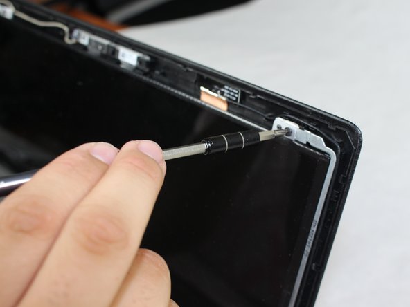

  6. Lenovo G40-30 LCD Screen Replacement: crwdns2935265:06crwdnd2935265:01crwdnd2935265:03crwdne2935265:0 Lenovo G40-30 LCD Screen Replacement: crwdns2935265:06crwdnd2935265:02crwdnd2935265:03crwdne2935265:0 Lenovo G40-30 LCD Screen Replacement: crwdns2935265:06crwdnd2935265:03crwdnd2935265:03crwdne2935265:0
    • Unscrew the four 7mm screws located on all four corners of the frame using a JIS #0 screwdriver.
    • Carefully lift the screen from the base so as to not damage it.

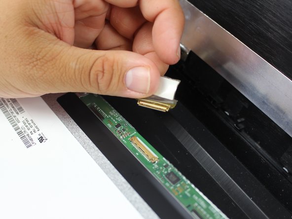

  7. Lenovo G40-30 LCD Screen Replacement: crwdns2935265:07crwdnd2935265:01crwdnd2935265:02crwdne2935265:0 Lenovo G40-30 LCD Screen Replacement: crwdns2935265:07crwdnd2935265:02crwdnd2935265:02crwdne2935265:0
    • Slowly remove the sticker connected to the rear of the screen using a spudger.
    • Carefully disconnect the screen from the base of the laptop.
