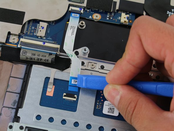

  8. Lenovo Flex 6-11IGM Trackpad Replacement, Trackpad: crwdns2935265:08crwdnd2935265:01crwdnd2935265:02crwdne2935265:0 Lenovo Flex 6-11IGM Trackpad Replacement, Trackpad: crwdns2935265:08crwdnd2935265:02crwdnd2935265:02crwdne2935265:0
    • Remove the connecting wire labelled "TP" by lifting the tab with the opening tool.

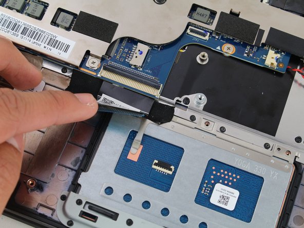

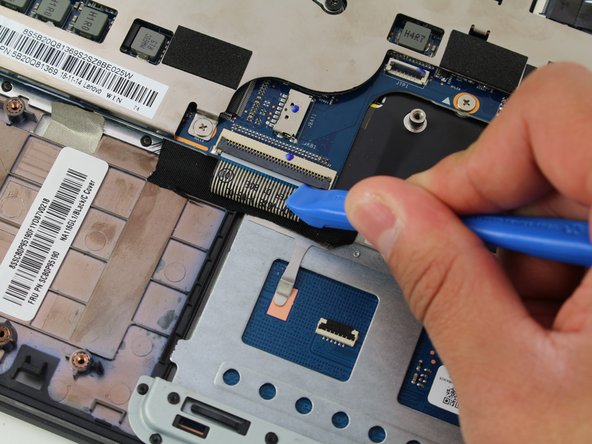

  9. Lenovo Flex 6-11IGM Trackpad Replacement: crwdns2935265:09crwdnd2935265:01crwdnd2935265:03crwdne2935265:0 Lenovo Flex 6-11IGM Trackpad Replacement: crwdns2935265:09crwdnd2935265:02crwdnd2935265:03crwdne2935265:0 Lenovo Flex 6-11IGM Trackpad Replacement: crwdns2935265:09crwdnd2935265:03crwdnd2935265:03crwdne2935265:0
    • Disconnect the keyboard ribbon from the motherboard by lifting the black tab and pulling the ribbon out with the opening tool.
  10. Lenovo Flex 6-11IGM Trackpad Replacement: crwdns2935265:010crwdnd2935265:01crwdnd2935265:01crwdne2935265:0
    • Pull up the black safety tape.

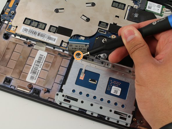

  11. Lenovo Flex 6-11IGM Trackpad Replacement: crwdns2935265:011crwdnd2935265:01crwdnd2935265:02crwdne2935265:0 Lenovo Flex 6-11IGM Trackpad Replacement: crwdns2935265:011crwdnd2935265:02crwdnd2935265:02crwdne2935265:0
    • Remove the three silver 2.3 mm Phillips #00 screws.
    • The third one is under the black tape.

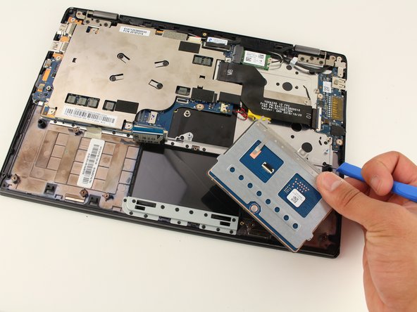

  12. Lenovo Flex 6-11IGM Trackpad Replacement: crwdns2935265:012crwdnd2935265:01crwdnd2935265:02crwdne2935265:0 Lenovo Flex 6-11IGM Trackpad Replacement: crwdns2935265:012crwdnd2935265:02crwdnd2935265:02crwdne2935265:0
    • Slide the trackpad up from its seat using the opening tool and remove it.
